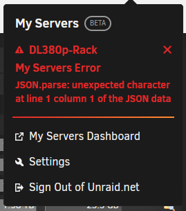

Hi All,
I have just installed and set up My Servers, while it works fine it always shows an error - does anyone know how to fix this;
Many thanks

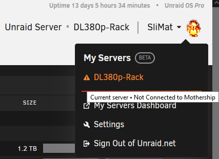

OK, at the moment there is no JSON error showing - but I do have this;
So, I ran the command from an SSH terminal;
But still have the "not connected" error ?
Everything seems to work fine - just annoying seeing this error showing.
It can take a few minutes for the connection to happen, but if it hasn't happened by now it probably isn't going to.
Would you please show me the output of this?
unraid-api report
unraid-api report
Yes, it still shows as not connected... here is the output;

There are a couple of different things mentioned in this thread. If you are seeing the message that says "JSON.parse: unexpected character..." then I'm guessing you are using a reverse proxy to access the webgui? Those are not currently supported.
If you run:
unraid-api report -vv
the section titled ALLOWED_ORIGINS will list the URLs that will work with your My Servers installation.
