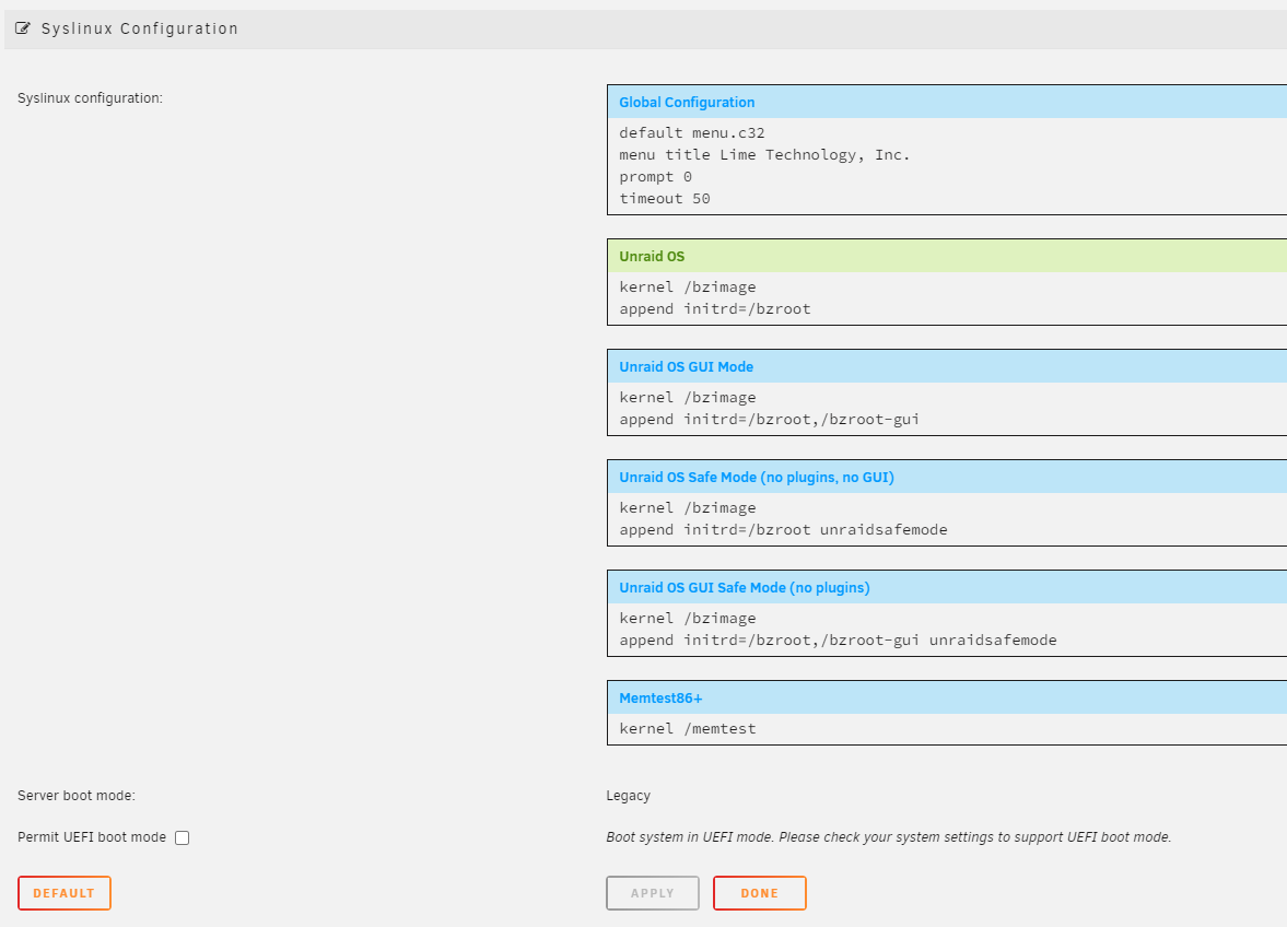

to possibly answer my #1 question, I can look and see how I'm currently booting under Main > Flash, go to bottom for this.
Server boot mode: Legacy
Permit UEFI boot mode <checkbox> mine is unchecked.
