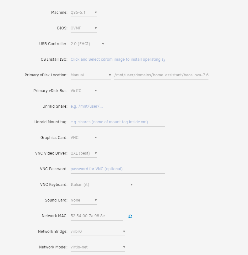

this is the VM configuration:

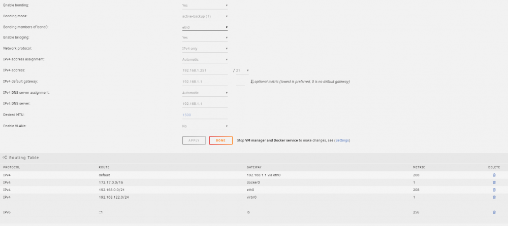

and this is network settings:
It seems to be all correct.

17 minutes ago, JonathanM said:
Your network bridge entry is wrong.
thanks!
how can I fix it?
You should set to br0 not virbr0,

the issue is that I don't have it :( image.png.61bd5b6f98f5ad5ff26193c5b61f9782.png
I notice you already enable bridge, but no bro in routing table, pls try reboot Unraid, if problem persists then post diagnostic.
Seems you haven't multi ethernet interface, pls disable bonding

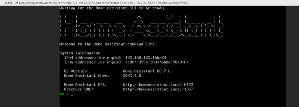

I fixed it!!!!
I saw that ip address of my unraid wasn't static!!!!
Set a static ip address, br0 was showed and now I can see home assistant!!
