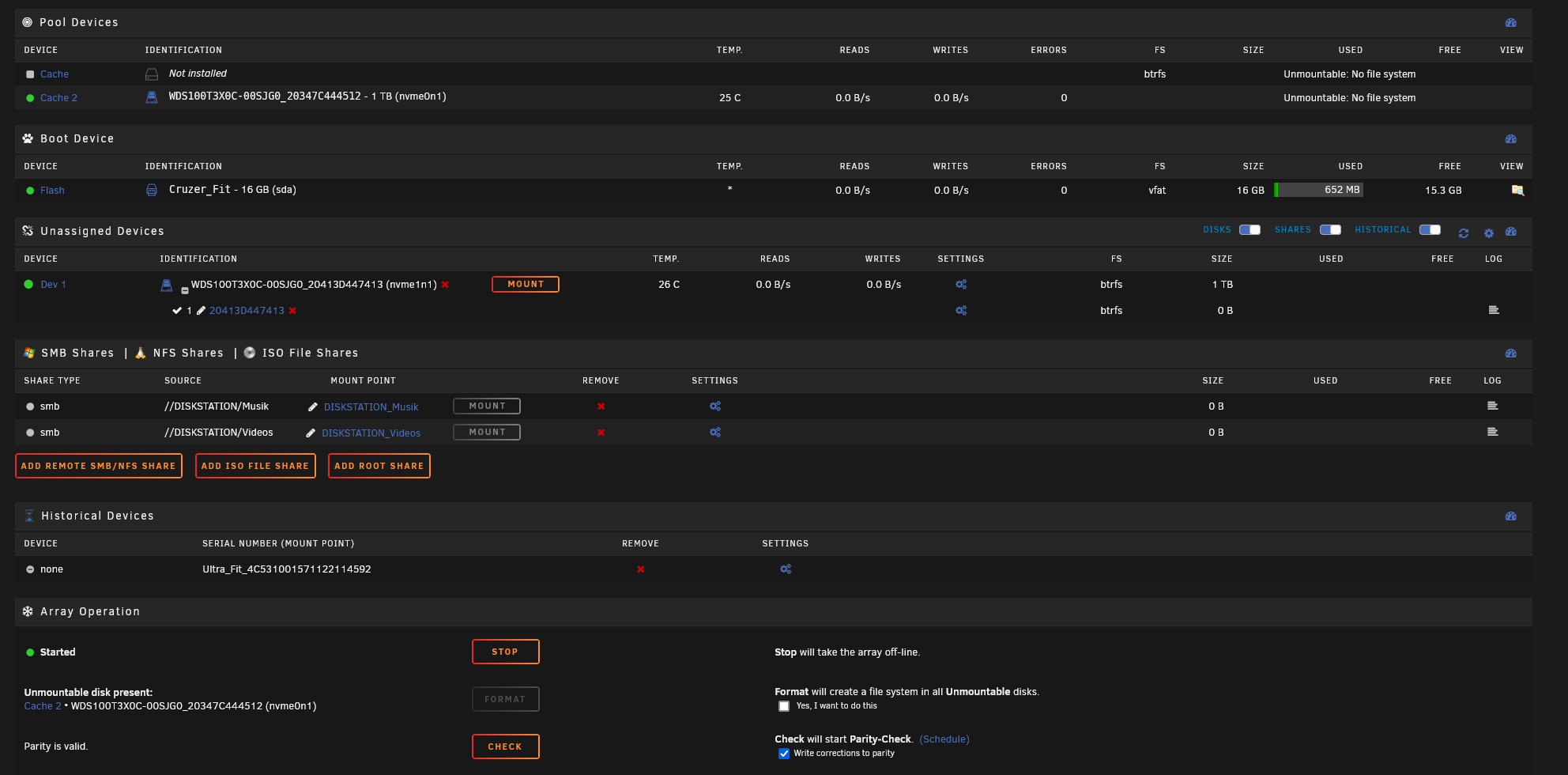

Hello guys,
today I went to the unraid Dashboard I don't know whats going on.
Every Monday I'm receiving a array health report and so it did on Monday, 25th. Everything just fine [PASS]
Now I noticed, thats Cache 1 NVMe is gone ...
and my shares are partially unprotected
Whats going on here? Hopefully rebooted my rig, but still the same
apollon-diagnostics-20220427-0803.zip
Solved by JorgeB
Is there supposed to be a cache1 NVMe device? If yes it's not being detected on a hardware level.
Thats the point. I have two identical WD NVMe drives set to a Cache Pool. Running since more than one year. Now Cache 1 drive is no longer detected ...

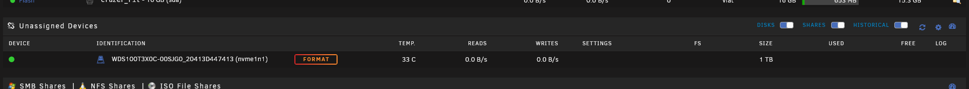

Hello, had some big problems with my machine. I`ve got a Enermax AIO watercooler and this little guy just damaged.
Was wondering my server was shut down. Then I started it, and just after booting and going to the Dashboard I've seen my lost Cache NVMe. But it was listed in UD 😀 (Yeah its alive)
Then I saw my Cache is: Unmountable: no filesystem.
After I realized this, the hole machine was hardly shut down. Went to the cellar and realized "Yes, my Server is offline." Took it, and connected it to a monitor to check the BIOS. Ohh hell. CPU Temp went in Seconds from 30°C to something 109°C and then it shut down. Checked the watercooler, disassembled it, cleaned the CPU and cooler block, applied new thermal paste and did another boot up. Same result.
Now I changed to the boxed air cooler and e voila, CPU is chilling at 42°C 😇
But what now to do with my broken Cache pool. Disc 2 is still part of the pool, but disc 1 is positioned at unassigned devices. Shoul I still check if NVMe 1 is broken ? SMART doesn't show any error.

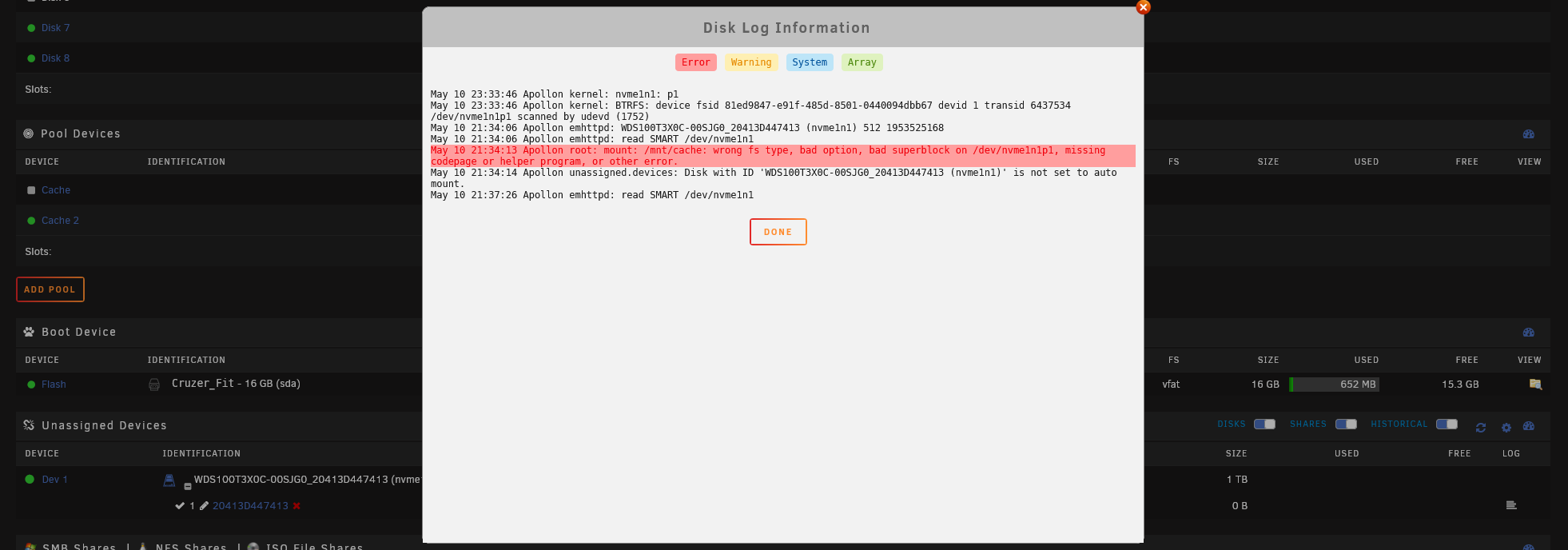

Only Information I found was for Dev 1 (Cache Pool NVME 1):
How can I restore the whole thing. All my Docker and Download Temp is/was stored in the Cache Pool ... 😪
May 11 15:36:33 Apollon kernel: BTRFS error (device nvme0n1p1): super_num_devices 1 mismatch with num_devices 1 found here
The superblock is corrupt, and the other pool member is way out of sync, though that's expected if it dropped offline earlier, you can try a backup superblock to see if it works, stop the array, type:
btrfs-select-super -s 1 /dev/nvme0n1p1
Then reboot and post new diags.

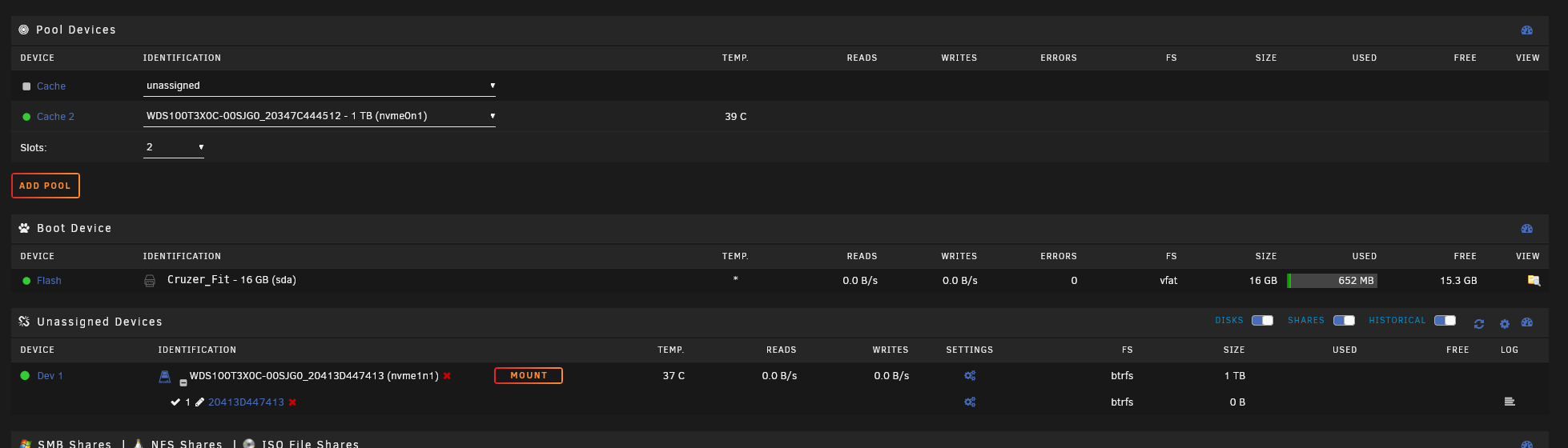

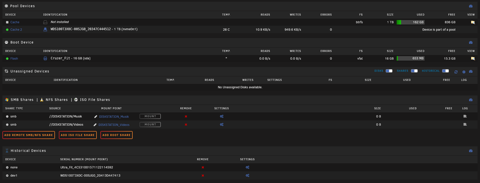

Hey, back again.
Did not have much time the last days, but I think I have partially some good news.
Disconnected the NVMe placed under UD and startet my rig.
But what to do now?
  1. Delete dev1 under Historical Devices ? (So I think when I put it back in again, unraid shouldn't places it under UD again)
  2. Stop Array, Set Number of Discs of Cachepool to 1 and backup my Data/move it to the Array ?
Or Should I now backup/move my Data to the Array ?
I think first I'll wait for @JorgeB to look at my diagnostics if everything is OK.
apollon-diagnostics-20220520-1035.zip
That's good news!
UD historical devices don't really matter for this, but you can remove it now or later, I assume you plan do re-add the other device o the pool?
