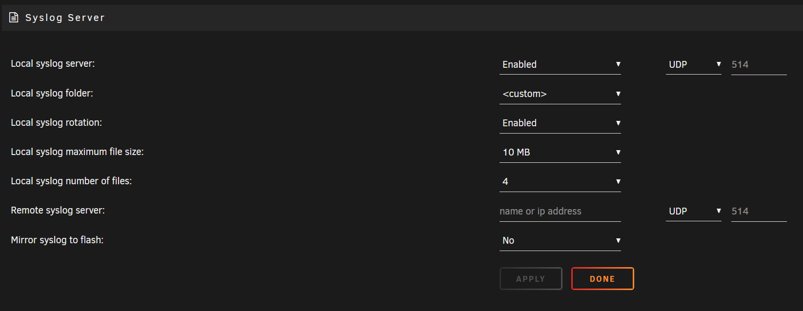

I'll enable the syslog server, thanks!
just saw it's already enabled
Since you are not Mirroring to flash (not recommended for extended use), you have to specify the Local syslog folder and the Remote syslog server (your Unraid server if you want).
AH! ok, I've setup a new share on cache for that and it started to log.
