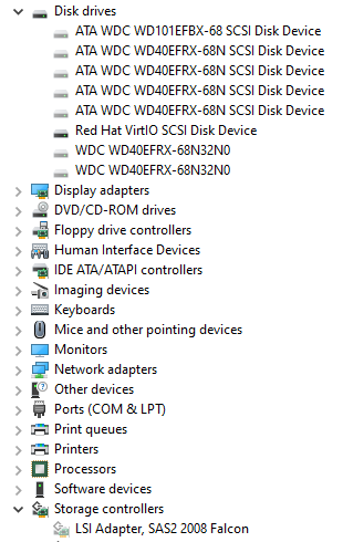

This morning, I edited the VM to remove the entire PCI section:
      <driver name='vfio'/>
      <source>
        <address domain='0x0000' bus='0x24' slot='0x00' function='0x0'/>
      </source>
    </hostdev>
After I started the VM, I went into Device Manager  > Hidden Devices, and I can confirm that the LSI card and all of the disks were indeed there at one point, they are gone now:
I can only assume this is an Unraid Bug because I'm sure I didn't add the HBA, and I've never had a SCSI controller end up in a VM like that.
