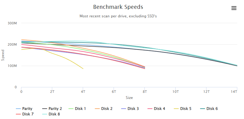

Diskspeed Test:

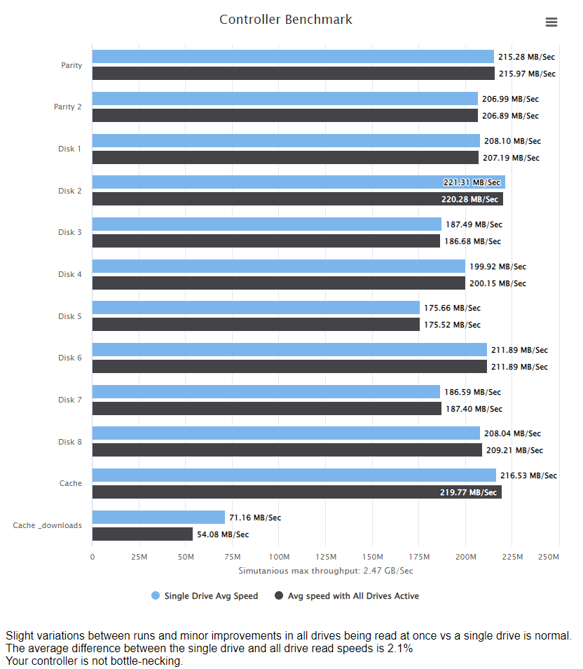

Controller Benchmark:
The cache_downloads SSD is dying but I don't think that should cause any issues with parity checks.

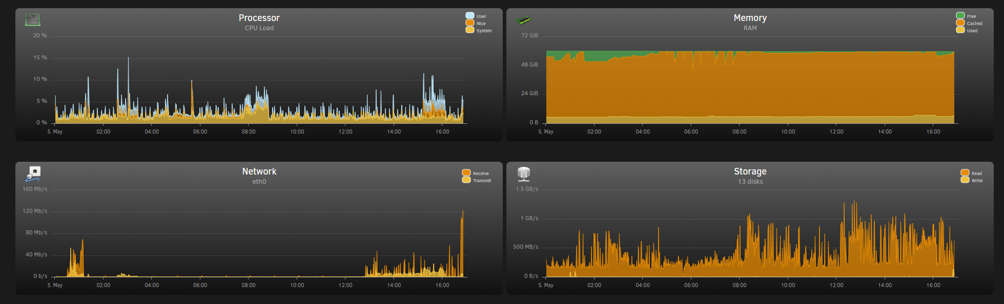

Some more info I can provide. The parity checks seem to speed up to 100mb/s and drops down to anywhere between 10-25mb/s. The speeds seem to increase and just drop down again. I have also attached another diagnostic while the speeds were at 2.9 mb/s. Hopefully this can be of use.
The speeds also seem to be slow even when the server is not being accessed.
zeus-diagnostics-20220505-1649.zip

That basically rules out any CPU issues, disks seem to be performing well so my main suspect for me would be the controller, not a bandwidth issue but some driver/compatibility issue, that controller is kind of an unknown since there aren't many used with Unraid.
