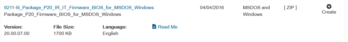

Is it worth updating the formware? I haven't touched it since buying it and I can't even remember what brand it is.

That firmware doesn't have any major issues AFAIK, but you should always upgrade to the latest, instructions here.
Thank you, it was your instructions thread that I was looking at. Very useful!
I might as well try the update now I've learnt how to do it.
Well, the firmware update went without a hitch, thanks very much @JorgeB
