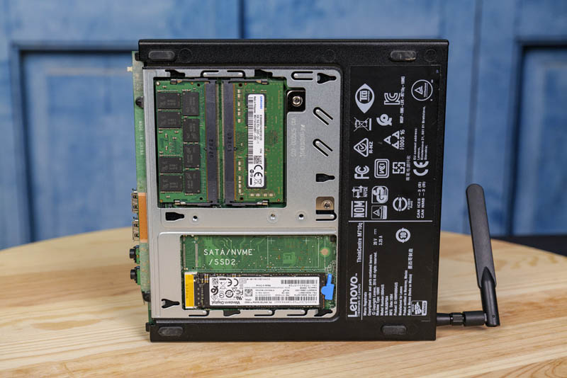

my plan is to build a cheap unraid server for my father. He is already using 2 HDDs with 6TB size.
The plan was to buy a refurbished Lenovo M710q Tiny Mini PC or HP Prodesk (or something similar to this), they are really cheap here (around 100€) with a i5-6500T, 8GB Ram and SSD.
Now I need a good solution to connect the existing HDD's to the unraid system. Since these mini pcs are obviously too small to fit the HDD's in it, I need an external enclosure or something similar. On another thread here, I already read that USB to SATA is not a good idea, so what would be the post solution to make the mini pc and the HDD's work together?
Another idea was to buy a nvme to sata port adapter and use them to connect the hdd's, would this be a better solution than a usb enclosure?
Thanks in advance.

Yes, but seems won't have enough space for cable / socket fan-out without modify the case.
I mean there is solutions for this. But is the nvme to sata adapter a legit solution or just slightly better than the usb3 connection?
Don't think M2 to PCIe, you can't mount the add-on card reliable and powering cable routing also not possible.
M2 to SATA should be the best solution.
USB3 always not recommend because hard to found one which work well or stable. But longtime ago, I use a 5bays USB enclosure, after fix all problem it serve me well, but actual bandwidth is limit to 300MB/s, so in worst case, each disk have 60MB/s only. But this solution really cheap and tidy.
