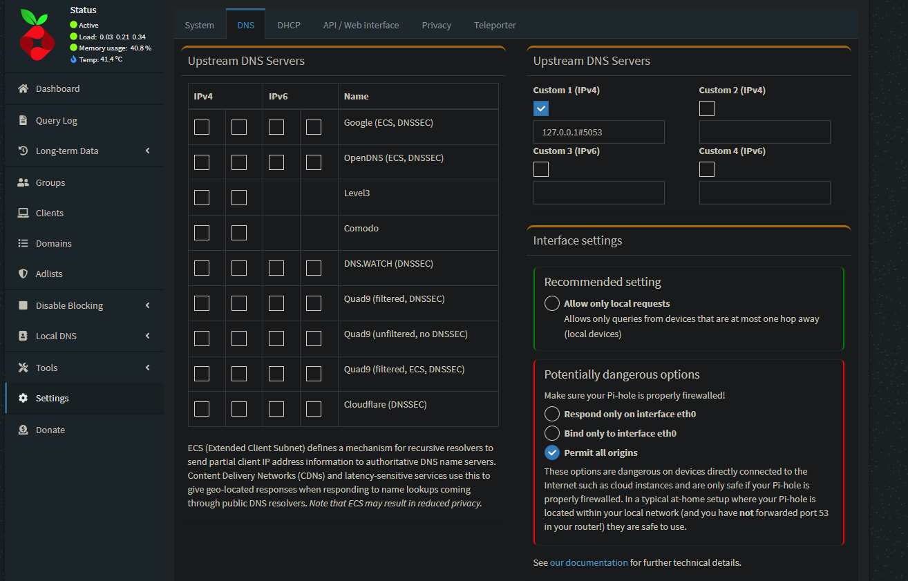

Since your VPN allocates IP addressess in a different subnet (10.253.x.x), in Pi-hole did you try change Interface settings to "Permit all origins" ?
@@Jarsky yes I have it set to permit all origins
