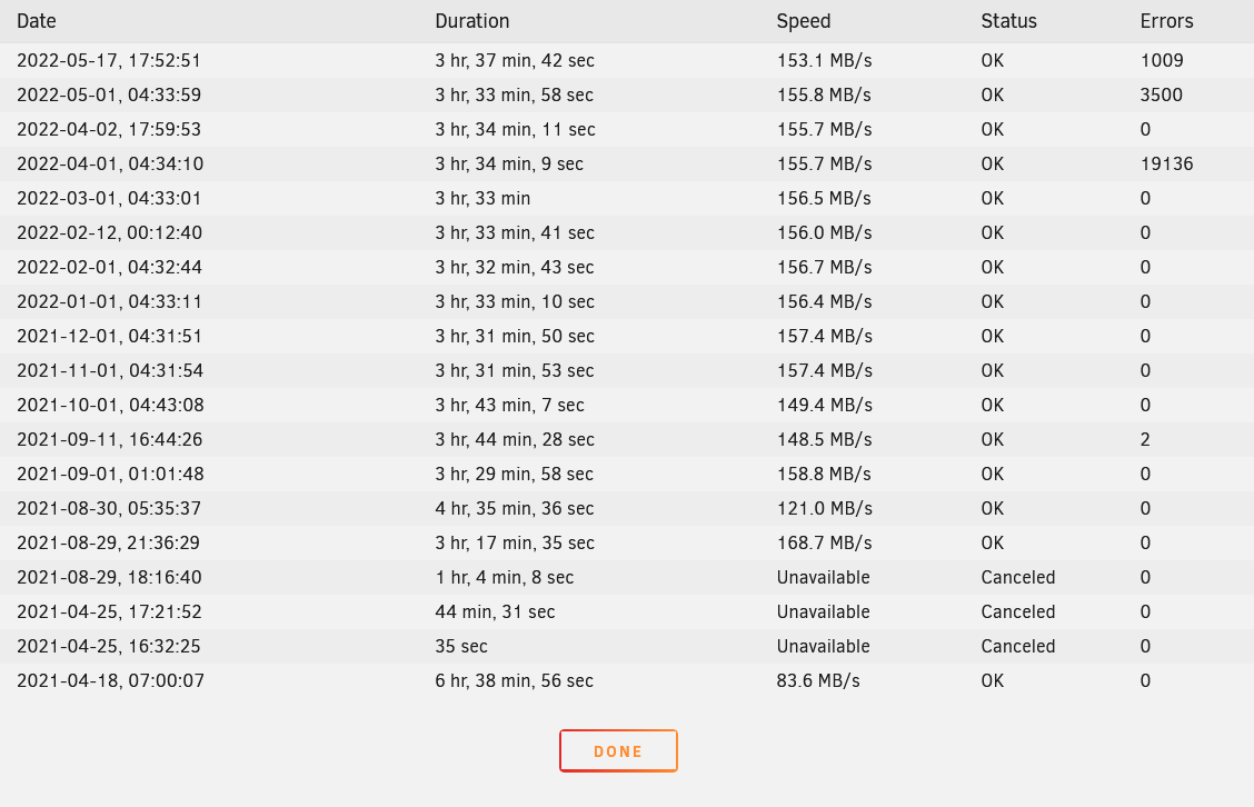

My unRAID server has now had parity errors over 3 checks - I thought one was a hard power-off, two was suspicious, I ran a third today which found more errors.
The only thing I've changed in my unRAID setup in the last 3 months was my main share's disk allocation method; from high-water to most-free. I suspect one of my disks which was unused before but now has data could be throwing these errors. Can anybody help me out?
How many?
Since these were correcting checks, and found parity errors for different sectors, and no obvious disk problems, the most likely suspect is RAM.
Have you done memtest?
You shouldn't even attempt to run a computer with RAM problems. Everything goes through RAM, the OS and any other executable code, your data, everything.
48 minutes ago, trurl said:
How many?

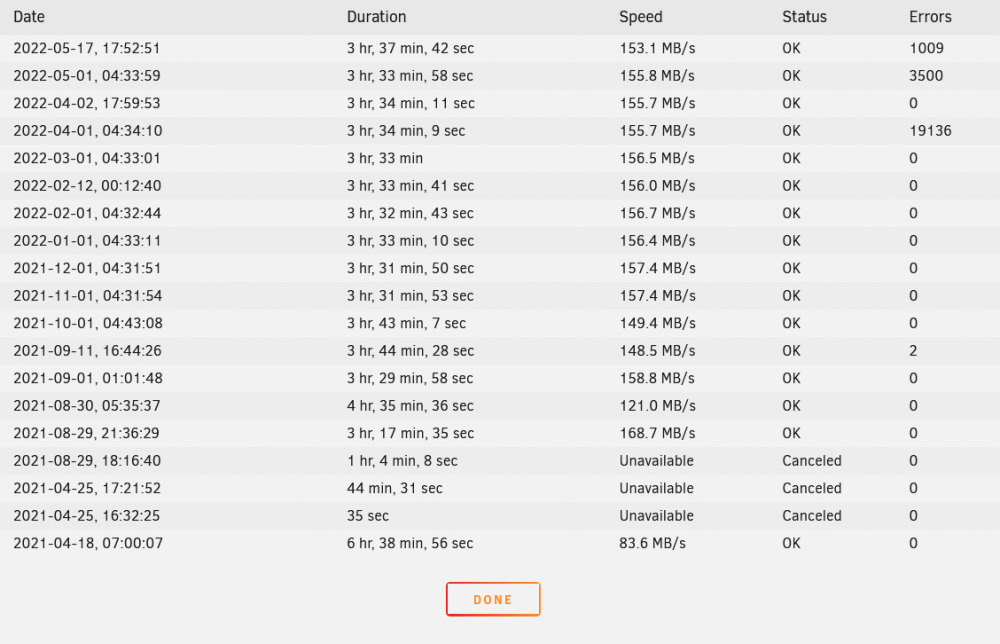

These are all the parity checks that have run on my machine.
Mesmtest is a good place to start, also note that Ryzen with overclocked RAM is known to in some cases corrupt data, though yours is not overclocked by much it still is.

4 minutes ago, ecnedac said:
Is it considered overclocking to run memory at its' rated speed
You also have to consider what is the maximum clock speed the motherboard+CPU combination is rated to support which is frequently lower than what your RAM is capable off.
