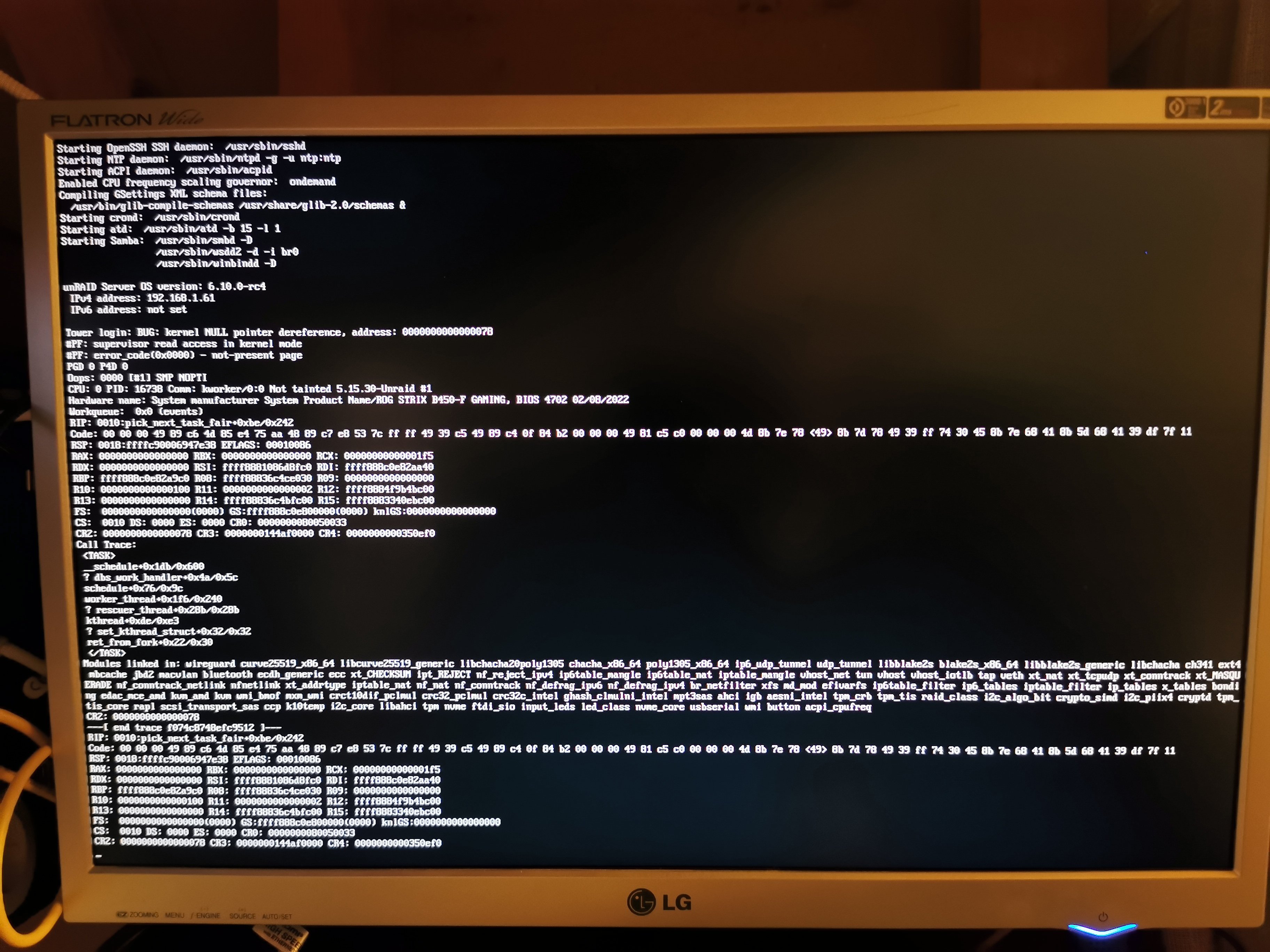

Kernel panic on boot

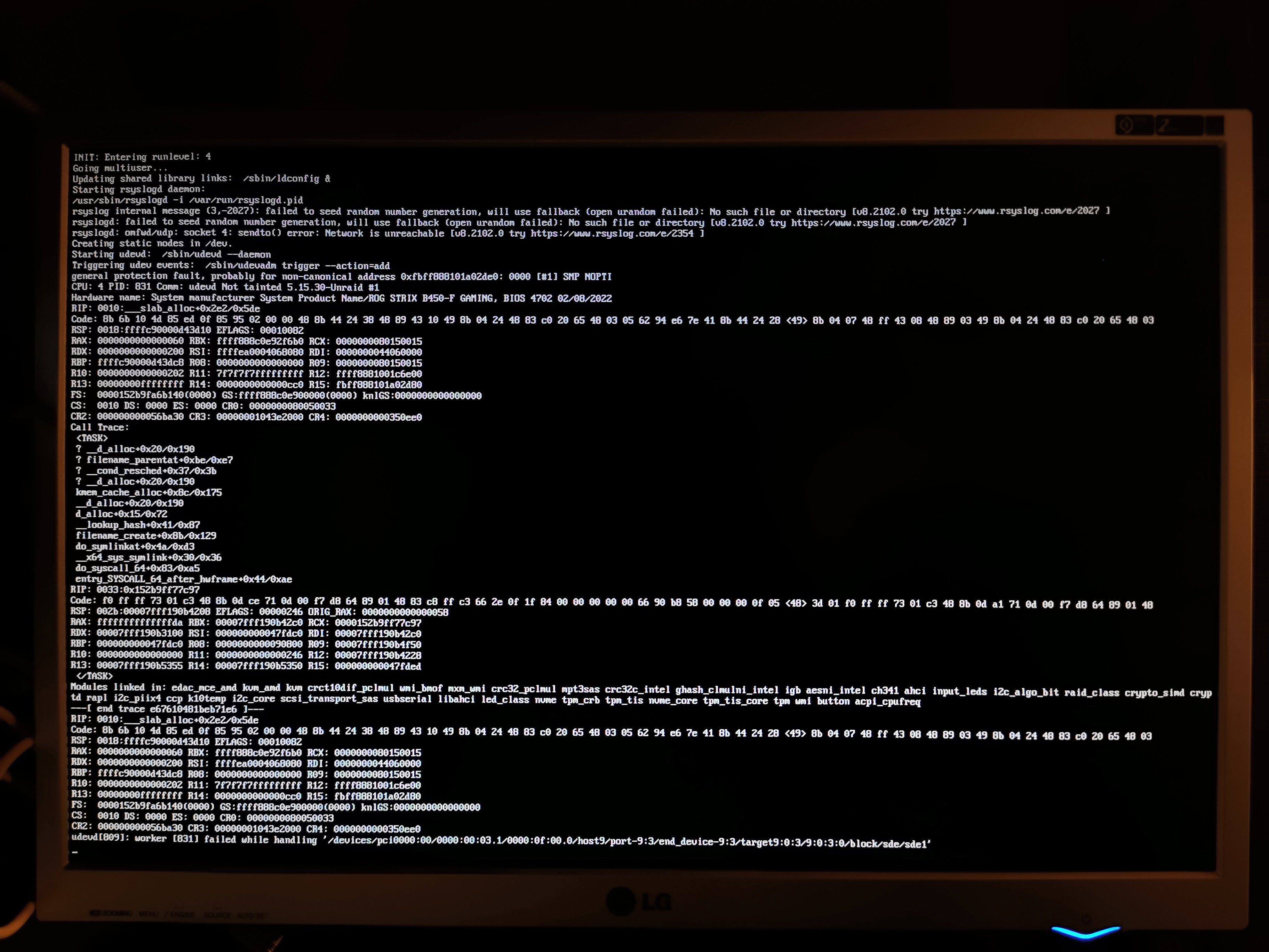

I've had quite a few problems with my install of Unraid 6.9 and 6.10 RC1-4 but lately it has been running quite smoothly. Until yesterday morning that is, when I realized my server had crashed again. Kernel panic at approx 5 AM, what a lovely way to start the day. I restarted the server and waited to see it come back up but no, there was a new kernel panic during boot (even during Safe boot). Can somebody please help me sort this out?
I can't really make anything out of the information from the first KP, the second one seems to stem from udev and some kind of disk failure (?) during boot? Needless to say, I can't access the server now.
AMD Ryzen 3600X, Asus ROG Strix B450-F Gaming (BIOS updated in February 2022), 48 GB RAM and a LSI 9240-8i HBA in IT mode. I've had my fair share of panics due to power management issues but it has been running for a month or so now.
Can anyone please shed some light on this?

Ok, so no luck today. Tried removing all my USB devices but ended up in kernel panic anyway. Tried removing all my HDDs too but ended up in kernel panic. There are still two m.2 SSDs connected but only because they're such a pain to remove. I can't even add the key file to the USB memory without it panicking.
I can't help thinking about HW issues, could my USB memory be corrupt even if I can write the Unraid image to it? A new one is only €12 so I might give that a try. Or should I ditch my AMD gear and spend another €300 on an Intel CPU and motherboard?
Edited by emilgil

Jun  9 19:47:19 Tower kernel: general protection fault, probably for non-canonical address 0xfbff888157600a70: 0000 [#2] SMP NOPTI
Jun  9 19:47:19 Tower kernel: CPU: 9 PID: 29474 Comm: sh Tainted: G      D           5.15.43-Unraid #1
Jun  9 19:47:19 Tower kernel: Hardware name: System manufacturer System Product Name/ROG STRIX B450-F GAMING, BIOS 4801 03/02/2022
Jun  9 19:47:19 Tower kernel: RIP: 0010:___slab_alloc+0x2e2/0x5de
Jun  9 19:47:19 Tower kernel: Code: 8b 6b 10 4d 85 ed 0f 85 95 02 00 00 48 8b 44 24 38 48 89 43 10 49 8b 04 24 48 83 c0 20 65 48 03 05 d3 f8 e2 7e 41 8b 44 24 28 <49> 8b 04 07 48 ff 43 08 48 89 03 49 8b 04 24 48 83 c0 20 65 48 03
Jun  9 19:47:19 Tower kernel: RSP: 0018:ffffc9000303fbb0 EFLAGS: 00010086
Jun  9 19:47:19 Tower kernel: RAX: 0000000000000070 RBX: ffff888c0ea70810 RCX: 0000000080200020
Jun  9 19:47:19 Tower kernel: RDX: 0000000000000200 RSI: ffffea00055d8000 RDI: 0000000044042000
Jun  9 19:47:19 Tower kernel: RBP: ffffc9000303fc70 R08: 0000000000000000 R09: 0000000080200020
Jun  9 19:47:19 Tower kernel: R10: 0000000000000202 R11: 0000000000000fe0 R12: ffff8881001cd100
Jun  9 19:47:19 Tower kernel: R13: 00000000ffffffff R14: 0000000000000dc0 R15: fbff888157600a00
Jun  9 19:47:19 Tower kernel: FS:  0000000000000000(0000) GS:ffff888c0ea40000(0000) knlGS:0000000000000000
Jun  9 19:47:19 Tower kernel: CS:  0010 DS: 0000 ES: 0000 CR0: 0000000080050033
Jun  9 19:47:19 Tower kernel: CR2: 00007fff11310f80 CR3: 000000015a2e2000 CR4: 0000000000350ee0
Jun  9 19:47:19 Tower kernel: Call Trace:
Jun  9 19:47:19 Tower kernel: <TASK>
Jun  9 19:47:19 Tower kernel: ? __alloc_file+0x26/0x9c
Jun  9 19:47:19 Tower kernel: ? rcu_segcblist_enqueue+0x12/0x33
Jun  9 19:47:19 Tower kernel: ? post_alloc_hook+0x21/0x4f
Jun  9 19:47:19 Tower kernel: ? kernel_init_free_pages.part.0+0x48/0x59
Jun  9 19:47:19 Tower kernel: ? prep_new_page+0x1c/0x48
Jun  9 19:47:19 Tower kernel: kmem_cache_alloc+0x8c/0x175
Jun  9 19:47:19 Tower kernel: __alloc_file+0x26/0x9c
Jun  9 19:47:19 Tower kernel: alloc_empty_file+0x9e/0xd3
Jun  9 19:47:19 Tower kernel: path_openat+0x46/0x94f
Jun  9 19:47:19 Tower kernel: ? cgroup_rstat_updated+0x21/0xa1
Jun  9 19:47:19 Tower kernel: do_filp_open+0x53/0xb0
Jun  9 19:47:19 Tower kernel: ? get_page+0x5/0xa
Jun  9 19:47:19 Tower kernel: ? lru_cache_add+0x35/0x54
Jun  9 19:47:19 Tower kernel: ? set_pte+0x5/0x8
Jun  9 19:47:19 Tower kernel: ? slab_post_alloc_hook+0x50/0x157
Jun  9 19:47:19 Tower kernel: ? getname_flags+0x29/0x150
Jun  9 19:47:19 Tower kernel: ? kmem_cache_alloc+0xff/0x175
Jun  9 19:47:19 Tower kernel: do_sys_openat2+0x72/0xde
Jun  9 19:47:19 Tower kernel: do_sys_open+0x3b/0x58
Jun  9 19:47:19 Tower kernel: do_syscall_64+0x83/0xa5
Jun  9 19:47:19 Tower kernel: entry_SYSCALL_64_after_hwframe+0x44/0xae
Jun  9 19:47:19 Tower kernel: RIP: 0033:0x148e08a24654
Jun  9 19:47:19 Tower kernel: Code: f9 41 89 f0 41 83 e2 40 75 2c 89 f0 25 00 00 41 00 3d 00 00 41 00 74 1e 44 89 c2 4c 89 ce bf 9c ff ff ff b8 01 01 00 00 0f 05 <48> 3d 00 f0 ff ff 77 2c c3 0f 1f 00 48 8d 44 24 08 c7 44 24 b8 10
Jun  9 19:47:19 Tower kernel: RSP: 002b:00007fff113109b8 EFLAGS: 00000287 ORIG_RAX: 0000000000000101
Jun  9 19:47:19 Tower kernel: RAX: ffffffffffffffda RBX: 0000148e08a35190 RCX: 0000148e08a24654
Jun  9 19:47:19 Tower kernel: RDX: 0000000000080000 RSI: 0000148e08a2ad7d RDI: 00000000ffffff9c
Jun  9 19:47:19 Tower kernel: RBP: 00007fff11310b70 R08: 0000000000080000 R09: 0000148e08a2ad7d
Jun  9 19:47:19 Tower kernel: R10: 0000000000000000 R11: 0000000000000287 R12: ffffffffffffffff
Jun  9 19:47:19 Tower kernel: R13: 0000000000000001 R14: 0000148e08a34040 R15: 0000000000418bd8
Jun  9 19:47:19 Tower kernel: </TASK>
Jun  9 19:47:19 Tower kernel: Modules linked in: xfs md_mod efivarfs iptable_nat xt_MASQUERADE nf_nat nf_conntrack nf_defrag_ipv6 nf_defrag_ipv4 wireguard curve25519_x86_64 libcurve25519_generic libchacha20poly1305 chacha_x86_64 poly1305_x86_64 ip6_udp_tunnel udp_tunnel libblake2s blake2s_x86_64 libblake2s_generic libchacha ip6table_filter ip6_tables iptable_filter ip_tables x_tables bonding igb mpt3sas i2c_algo_bit raid_class ch341 input_leds edac_mce_amd kvm_amd kvm wmi_bmof mxm_wmi crct10dif_pclmul crc32_pclmul crc32c_intel ghash_clmulni_intel aesni_intel crypto_simd i2c_piix4 cryptd rapl ahci ccp k10temp led_class i2c_core scsi_transport_sas usbserial tpm_crb libahci nvme tpm_tis tpm_tis_core nvme_core tpm wmi button acpi_cpufreq
Jun  9 19:47:19 Tower kernel: ---[ end trace 433c4d1883a374bf ]---
Jun  9 19:47:19 Tower kernel: RSP: 0018:ffffc90003e4fc70 EFLAGS: 00010082
Jun  9 19:47:19 Tower kernel: RAX: 0000000000000050 RBX: ffff888c0e9b0690 RCX: 0000000080150015
Jun  9 19:47:19 Tower kernel: RDX: 0000000000000200 RSI: ffffea000424bcc0 RDI: 0000000044042000
Jun  9 19:47:19 Tower kernel: RBP: ffffc90003e4fd30 R08: 0000000000000000 R09: 0000000080150015
Jun  9 19:47:19 Tower kernel: R10: 0000000000000202 R11: ffff88814e780020 R12: ffff8881001cc500
Jun  9 19:47:19 Tower kernel: R13: 00000000ffffffff R14: 0000000000000cc0 R15: fbff8881092f3780
