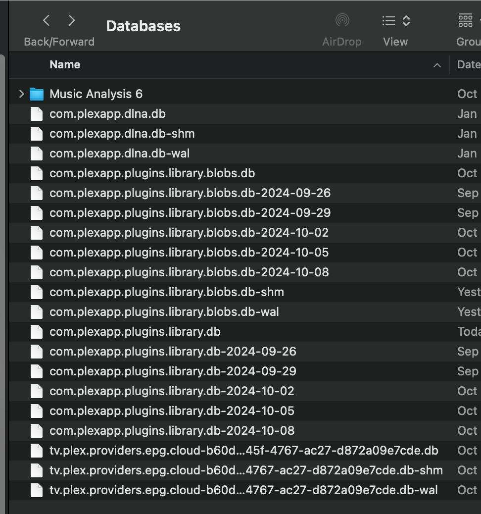

October 11, 20241 yr My Databases folder has a lot more files than the instructions above mention (the delete and replace instructions that seem to be working for everyone). My files have "dlna" in the name and I have a ton of extra files there epg episode guide files and a music analysis folder. Should I get rid of those as well? Thanks!
