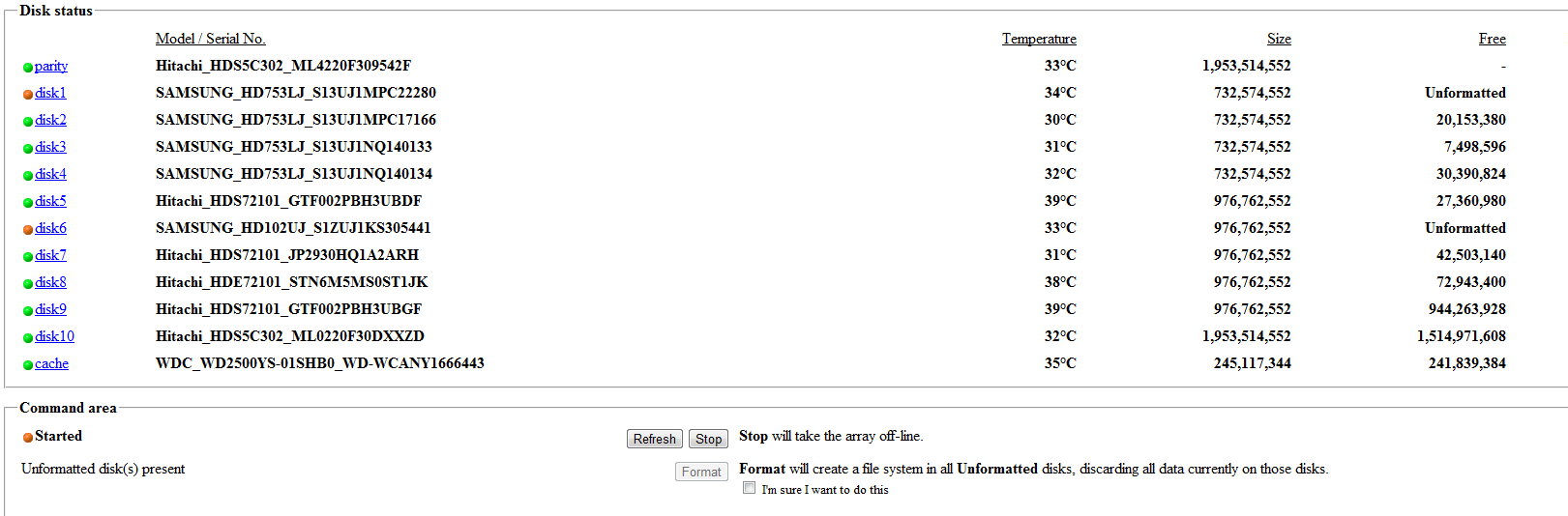

Also, what's the difference between the red and orange dots?
Thanks, so....
My "yellow" drive should be "A data disk has this status during Reconstruction" and yet there doesn't seem to be any reconstruction going on.  I'm guessing that's because I'm having trouble with the second disk?

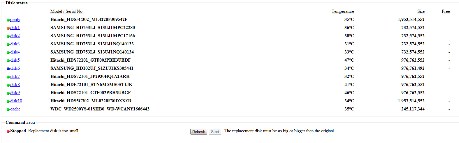

Ran Disk6 through Spinrite and it didn't find anything.  However it now shows as being too small so something changed.  How do I fix this?
Ok, this screenshot is after I removed the HPA problem which I picked up trying to run Spinrite on another system.  This is slightly different than previously because both drives are now yellow (orange really).  Is that a good thing or inconsequential?
