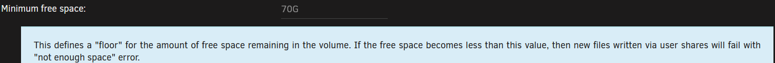

You can find the information here in the online documentation that can be accessed via the Manual link at the bottom of the GUI.

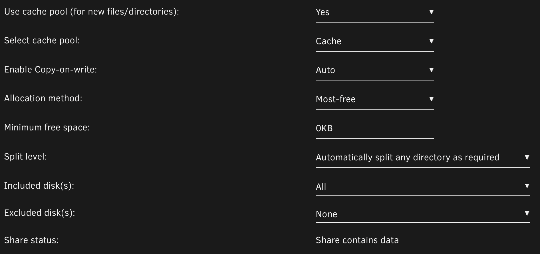

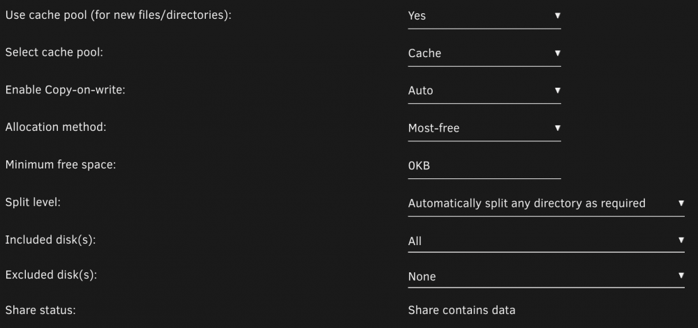

I have split any directory enabled - settings below.
I will set the min space to 100G or something like that, when move has finished and I can stop the array. I still don't understand why a disk full error is being generated though, because surely the min space setting shouldn't matter - if it's X% full, or 100% full, further writes should go to the array according to the help / docs?
1889594064_Screenshot2022-06-05at11_59_38.thumb.png.b743f3f868f25a38cb4bef3d56cdc5b5.png

It does matter, you must set a minimum free space for the share and should also set one for the pool, the one for the share should be set at about twice the size of the largest file you expect to copy to that share.
