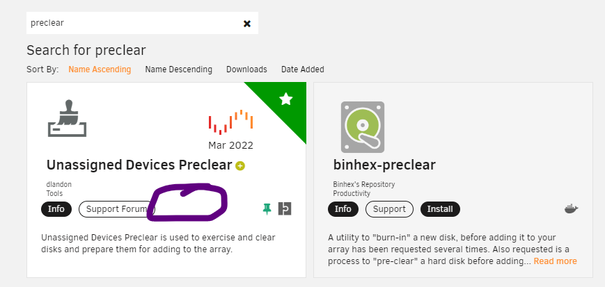

I had to setup my UNRAID boot USB disk again and install all of my plugins again.  Why is the install button missing?
It's not installed and there's no ACTION button either.

Any ideas why preclear has no install button?

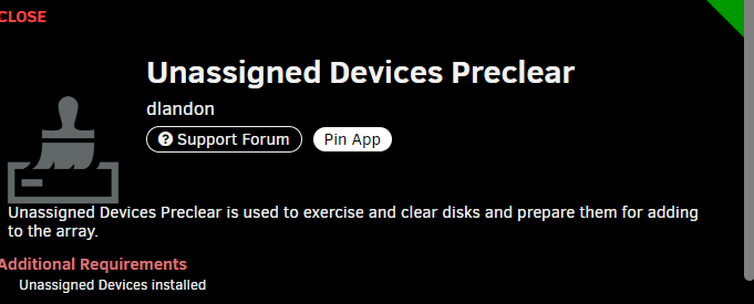

Clicking anywhere on the card (or the info button) brings up the sidebar which will tell you that it requires Unassigned Devices, and that requirement isn't met (hovering over the + on the card will also tell you that it requires UD installed)
You're absolutely correct!  But, can you please post a screen shot of what you mean?  I don't see any listed dependencies in the sidebar?

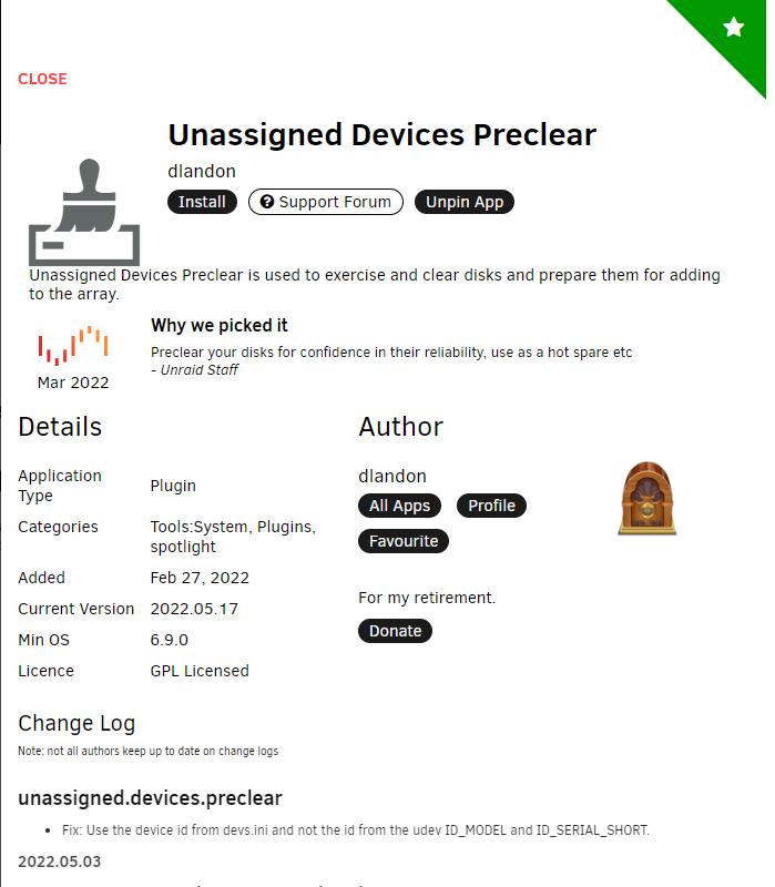

It seems you already have the Unassigned Devices plugin, and you're able to install it now.  The button is showing in your screenshot.
It took me forever (or maybe just a few hours) to figure out that the prerequisite of having "Uninstalled Devices Installed" meant another plugin and not that I had uninstalled devices in my server.  It's not clear at all and a couple of extra words would eliminate that confusion.
