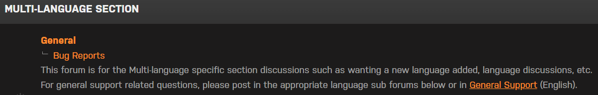

Please, il you want to post in the General support forum, use English.
If you cannot / would not, then post in your native language sub section.
On 6/10/2022 at 12:02 AM, Andiloerken said:
Egal ob ich eine SSD per passthrough einbinde , oder es auf Auto stelle (Cach)
Siehe:
