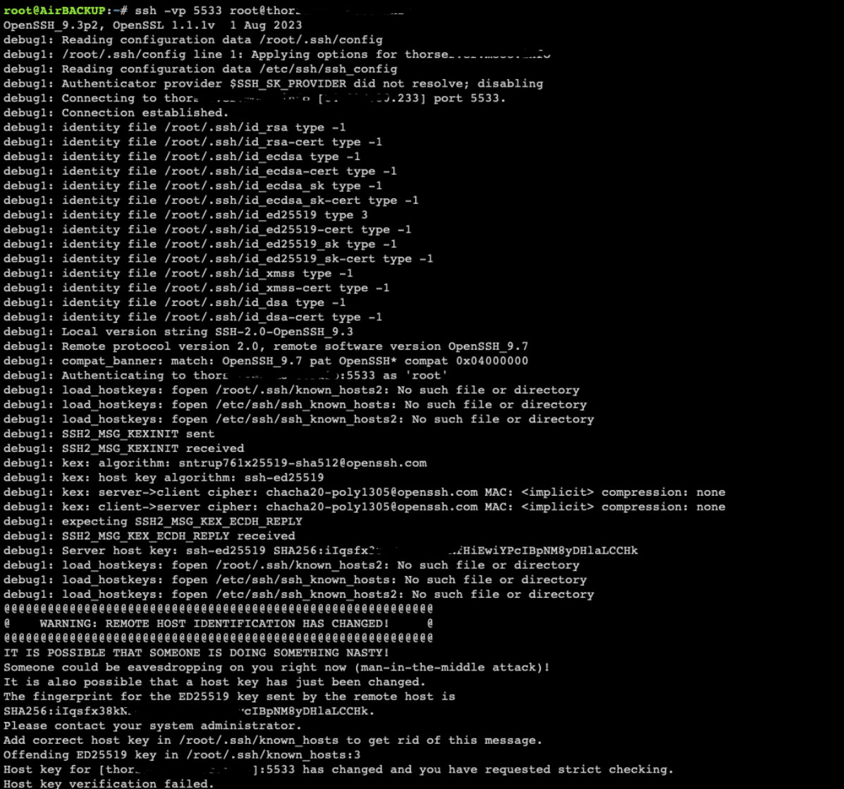

since the last update of the rsync-server docker, the client is not able to reach the server with SSH anymore. The key shown under SSH_AUTH_KEY_1 and the key I get with "cat ~/.ssh/id_ed25519.pub" on the client are the same.
But if I run the test "ssh -vp 5533 root@thor***" it returns an error and shows a different fingerprint.
Network in the template is set to bridge.
This worked for more than a year like a charm till the update.
Any suggestions?
Thank you very much in advance!
I solved it by deleting the entry from known_hosts. But now the question would be if it was safe to do so?
