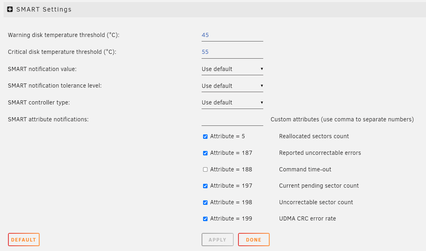

Click on the device designation in UD for the device in question and make a change to the SMART settings and then click 'Apply'.  This will set up disk monitoring by serial number and not devX.  I don't know how hwmon works so I don't know if it will work, but I suspect it will.

@dlandon i dont seem to have device designation...  could you send some pics?   i was wondering there is
for "disk name" from  dev1 2 3 4    it has for my un assigned drives
if i change the disk name from dev1  to the serial number of the drive?
i click also the DEV1   for the 1 usb drive  and looked at all the sub headings but nothing to change smart settings for device designation.. maybe you could send a few screen shots, would help
Click on the 'Dev 2' or whatever the designation is::
This is where to make a change:
ok you lost me   under smart  there is no
"device designation"
cuz you said  "a change to the SMART settings and then click 'Apply'.  This will set up disk monitoring by serial number and not devX."
i dont see "device designation" to click under smart  to hit apply .. and disk monitoring will change  dev2  to like serial number
reason i asked if i just change "disk name" from "dev2 " to the "wdc-xxxxxx"(serial number)  that you have
cuz under the smart settings you see there is nothing that says "device designation" for me to change  to serial number and not DevX
and none of the 3 "defaults"  have an option of "device desgination"  under drop downs
so i cant selection this device designation option
so i kinda lost
Edited by comet424

Clicking the device designation brings up the SMART page.  Then make a change to any parameter on the SMART page  You can change and then change it back.  The Apply button will be active, then click it.  This will set the monitoring to the serial number.  You don't change the devX here.
oh your talking about the "Device name"    dev1 dev2
not look for the word "device designation" way you wrote it.. i been looking for the word  "device designation" and then i check off a box   so id enable  device designation  over what its doing now   dev1 2 23   or sda sdb sdc
either way didnt work still changes
