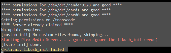

19 minutes ago, ConnerVT said:
This message means that Plex did not find a USB TV Tuner device. 99%+ of all Plex users in the world have this in their log. It can be ignored.
As ConnerVT said, the libusb_init error message can be ignored. The message appears in the logs every time Plex starts (unless you have a usb TV tuner). Note the line in red in my Plex logs. Plex tells you to ignore it.
