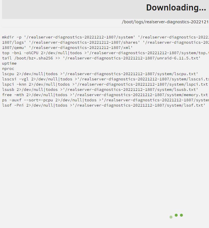

  10. My filerun stopped working and would not restart, while most other dockers were still ok. Grafana and Mosquitto could not start. So I turned docker service off, and back on, it reported the same issue. Rebooted, same issue. I tried to backup appdata with CA plugin, but the status part always stops at filerun/system/data. I will leave it overnight and see if it gets any further. I am downloading diagnostic, but it is stuck at "lsof -Pni 2>/dev/null|todos >'/realserver-diagnostics-20221212-1807/system/lsof.txt'"

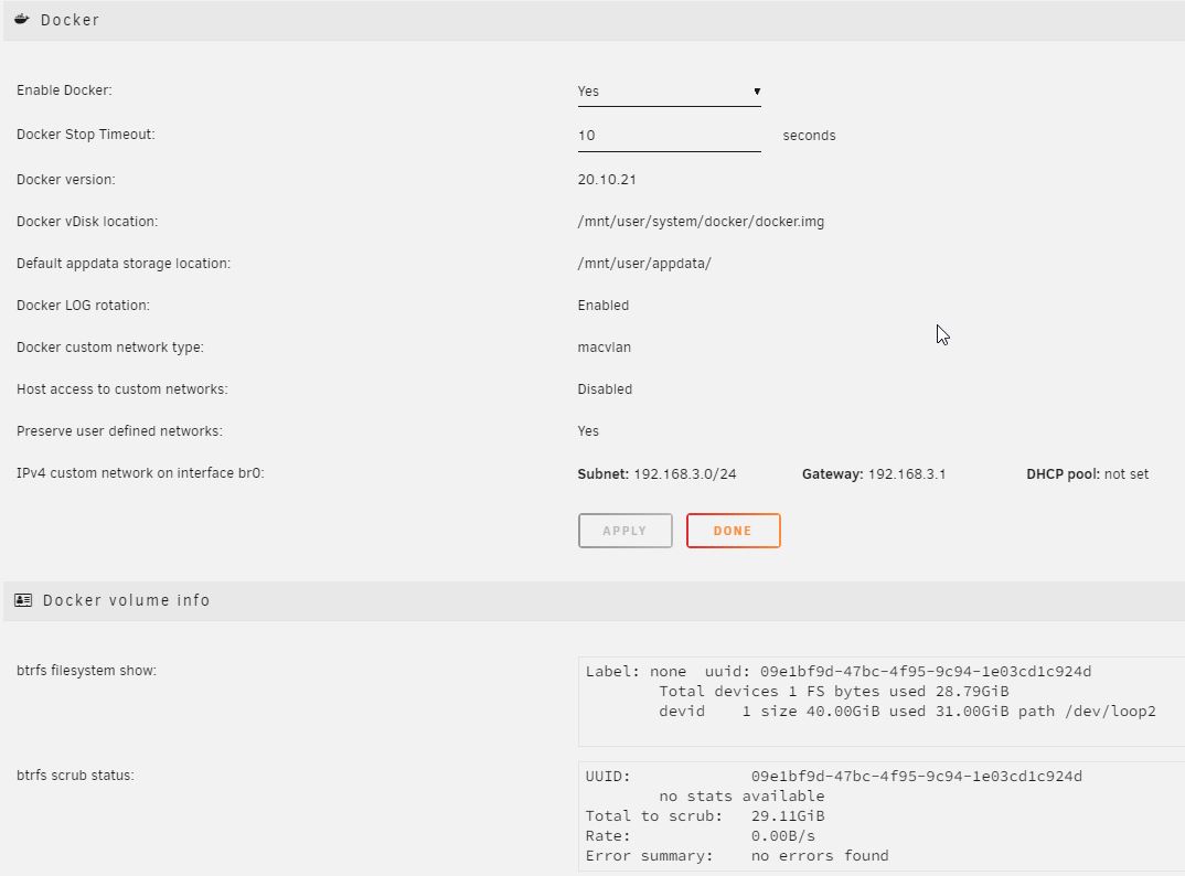

  11. I have no idea what is taking 20GB in docker image. Name Container Writable Log Filerun-ofi 1.79 GB 3.05 MB 2.91 MB baidupan 1.41 GB 38.6 MB 30.7 kB binhex-delugevpn 1.37 GB 10.4 MB 14.5 MB Chrome 784 MB 330 kB 4.92 kB Plex-Media-Server 716 MB 58.2 MB 11.8 kB Netdata 587 MB 186 MB 963 kB krusader 486 MB 23.7 kB 15.7 MB sonarr 403 MB 29.4 MB 26.4 MB jackett 379 MB 107 MB 25.6 kB Grafana 315 MB 0 B 234 kB mariadb 287 MB 21.5 kB 6.95 kB Postgres11 284 MB 63 B 12.1 MB radarr 246 MB 18.0 kB 9.10 MB NginxProxyManager 192 MB 16.3 kB 167 kB TeslaMate 182 MB 3.48 MB 4.67 MB mosquitto 13.1 MB 0 B 12.9 kB Total size 9.44 GB 437 MB 86.9 MB
  12. I am looking into this as well. How can I find out what's in the docker image? Thanks.
  13. I changed it to 40G and it was doing the same. Half a day later, I updated unraid to 6.11.5, rebooted, everything started working normally. Here is the new diagnostics: realserver-diagnostics-20221212-0952.zip
