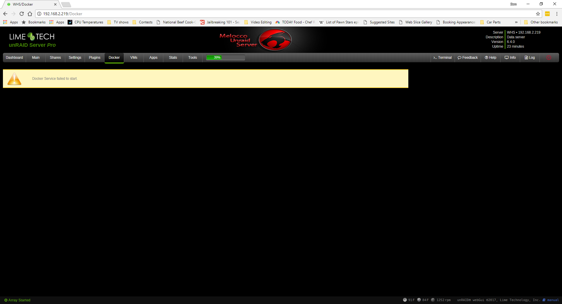

Ok..   I know this has nothing to do with it..  But since I paid for unraid, I've had it lock up and a few other things.  Anyway, Here  is what's going on now.
I had unraid ether crash or lockup or something about 15 minutes after putting in the paid key. It stopped responding on the computer I was using. I then went to the main computer with a monitor and keyboard. I already had the gui running since I'm still making sure everything is transferring and everything like it should. On the screen (computer running unraid) it was still on username for login. I couldn't do anything. I waited a few minutes and tried again. Still nothing..  So I unplugged it. Yes I made sure no activity lights was going.
Once I started it up, everything was good except that the dockers wasn't there..  I went to restart the server again (using the restart button) and it starts then goes to a black screen and is still running..  Monitor cuts off, but fans etc still going..
I waited again, then unplugged it again..  I started it back up and it was running fine. All the dockers etc was running like it should have been. Then it stopped responding again..
Now, it still doesn't shut down, and the dockers are gone (with the error Docker Service failed to start. ) So now I'm stuck with just a broken OS..   Any Ideas on what I can do to repair this?  As I said in the beginning, it all started right after I put the paid key in. Before that It was running smoothly..
Also, I'm running 6.4.0

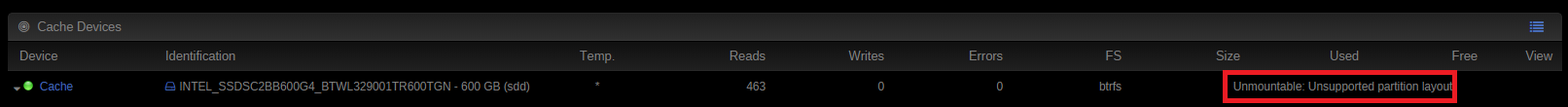

I just noticed that my cache drive is not mounting after the 6.4 upgrade...which makes sense as to why my VMs are not available.
Any advice or questions would be appreciated.5a5db44132bf4_cachedrivenotmounting.thumb.PNG.87848d938d87b80802dc2c53b54c09db.PNG

It starts up some times and sometimes not..  It started up when I unplugged it and forced it to restart.  I tried to get a new dio. while it won't start but after 10 minutes of waiting, it never downloaded.. The dockers are also acting funny.. Krusader says it's running, but I have issues logging in. It sometimes starts to the main login screen, sometimes it doesn't start up at all, (see picture below). Plex does the same thing..  Sometimes it starts up, sometimes not.. It streams slow and transfers are very slow..  After thinking about it, I did upgrade the os a day before putting the key in..  Could I go back to 6.3.5? I backed up the flash card (wasn't sure the best way, so I just copied the flash card to a folder on my workstation). I don't know if that is the issue or not..  But I didn't have half the issues I'm having now...   Any Ideas?
Docker images shows write errors, these could be hardware related your not enough space on the device where the docker is:
Jan 15 21:35:22 WHS kernel: BTRFS info (device loop2): bdev /dev/loop2 errs: wr 675, rd 0, flush 0, corrupt 0, gen 0

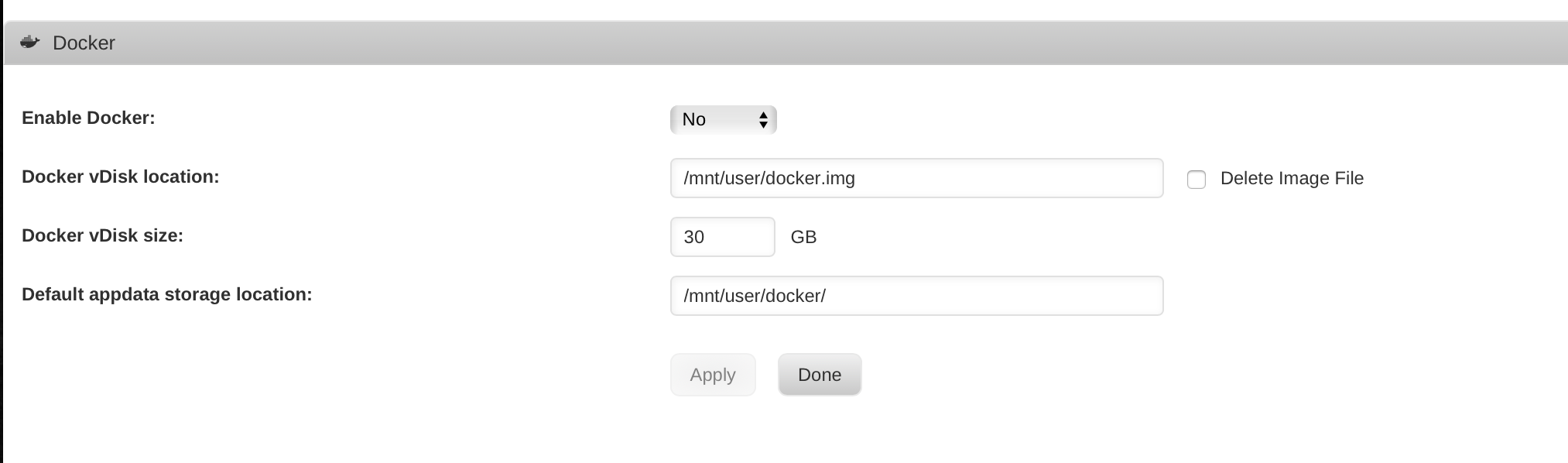

Ok

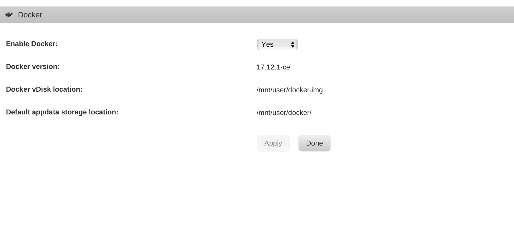

My issue got resolved,   by increasing Docker Virtual disk image size from 20 to 30GB
Settings "Docker" ---
"Enable Docker :  click no,
and Apply settings.
Then you will see docker "image size " by increasing docker image size from 20 to 30GB,  screen shot attached where you increase size
5ab2c080d5978_ScreenShot2018-03-21at4_28_19PM.thumb.png.115f6da2074d02b49ec04050fb31d119.png
Edited by cableshark
This is probably only temporary until it fills up again. 20GB would likely be plenty if you had things setup correctly.
You need to figure out why it is filling up. See "Docker Image Filling Up" in the Docker FAQ:
