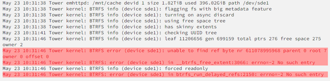

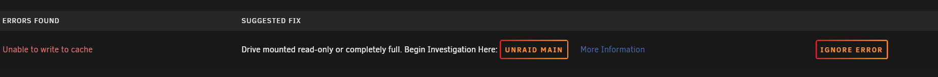

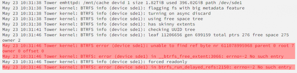

image.thumb.png.c1d440ed98e4c23e6834380d81ac916d.pngI'm guessing this is the issue but don't know how to proceed
Cache filesystem is going read-only:
May 23 10:31:46 Tower kernel: BTRFS info (device sde1): forced readonly
Best way forward to make sure it's fixed is to backup anything else important on cache and re-format it, then restore the data and re-create the docker image.
