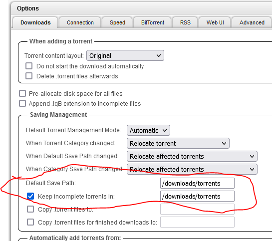

I attempted to run a few VMs in the past but never did anything with them and removed everything. I am using a Win machine to access the file shares and have looked at the data in the "appdata" location.  It's Qbit that caused the build up, all the downloaded files over the past year have filled the drive [due to my incompetence in config] and now without permission to remove the files I'm kinda in a rock and a hard place.  Is there a command or config you would suggest I use to clear that "downloads" folder?  I'll just rebuild it. [Correctly this time]  and thank you for your expertise and assistance.

This is where I messed up.  these settings were set to go the the /config/qbit/downloads  This is what was filling up my downloads folder in the cache.  Made these changes and all seems to be running WAY better, with only 50% of the cache drive pool being utilized. Thank you again for your help on this.
