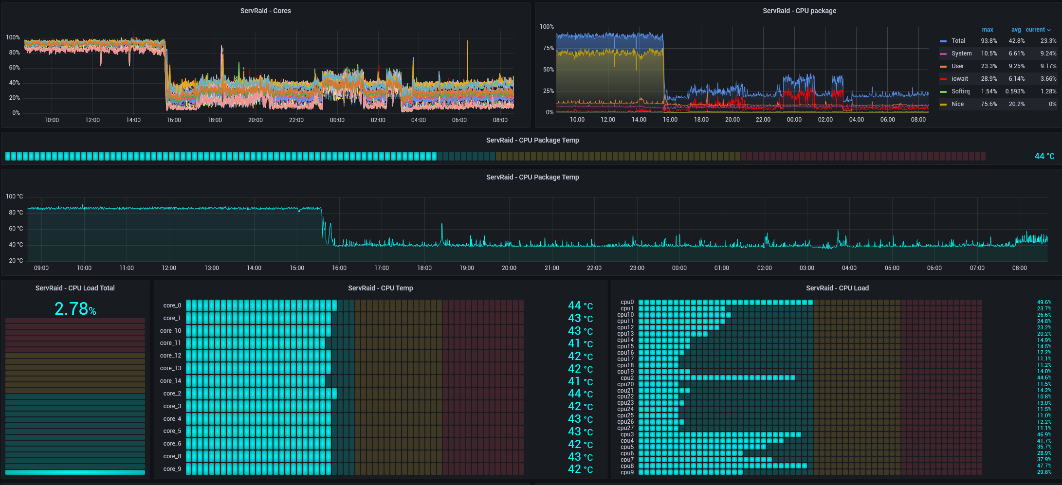

In fact it's ok. I was doing some heavy encoding a cpu reached 80c. But now it's sitting at 25c and it's still throwing these message, which is weird.

Are you positive you are monitoring the correct sensor? Sometimes the names are misleading.

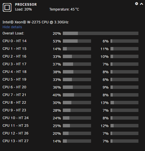

Yeah, I have a graph with the temp of all cores. CPU is sitting idle running right now between 40 and 50C. Everytime I start to have CPU throttling, it never stop until I restart unraid. Don't know why, and it happen when I run FileFlows using all CPU/Core. I don't monitor CPU hz, I should check that. I'm not even sure my CPU support throttling
