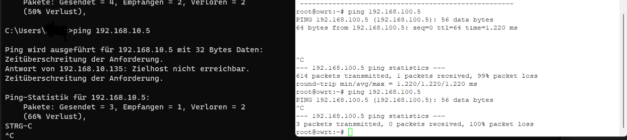

Curiously, it has also happened that I could access the second interface in a separate network and act. There was nothing in the log.
On the other hand I did a ping on the second NIC (192.168.100.0/24 as planned network, current primary is 192.168.10.5 with /24. By this time, ping on primary was not possible already), which did not work after the second ICMP ECHO:
PING 192.168.100.5 (192.168.100.5): 56 data bytes
64 bytes from 192.168.100.5: seq=0 ttl=64 time=1.391 ms
64 bytes from 192.168.100.5: seq=1 ttl=64 time=0.884 ms
next request:
--- 192.168.100.5 ping statistics ---
20 packets transmitted, 1 packets received, 95% packet loss

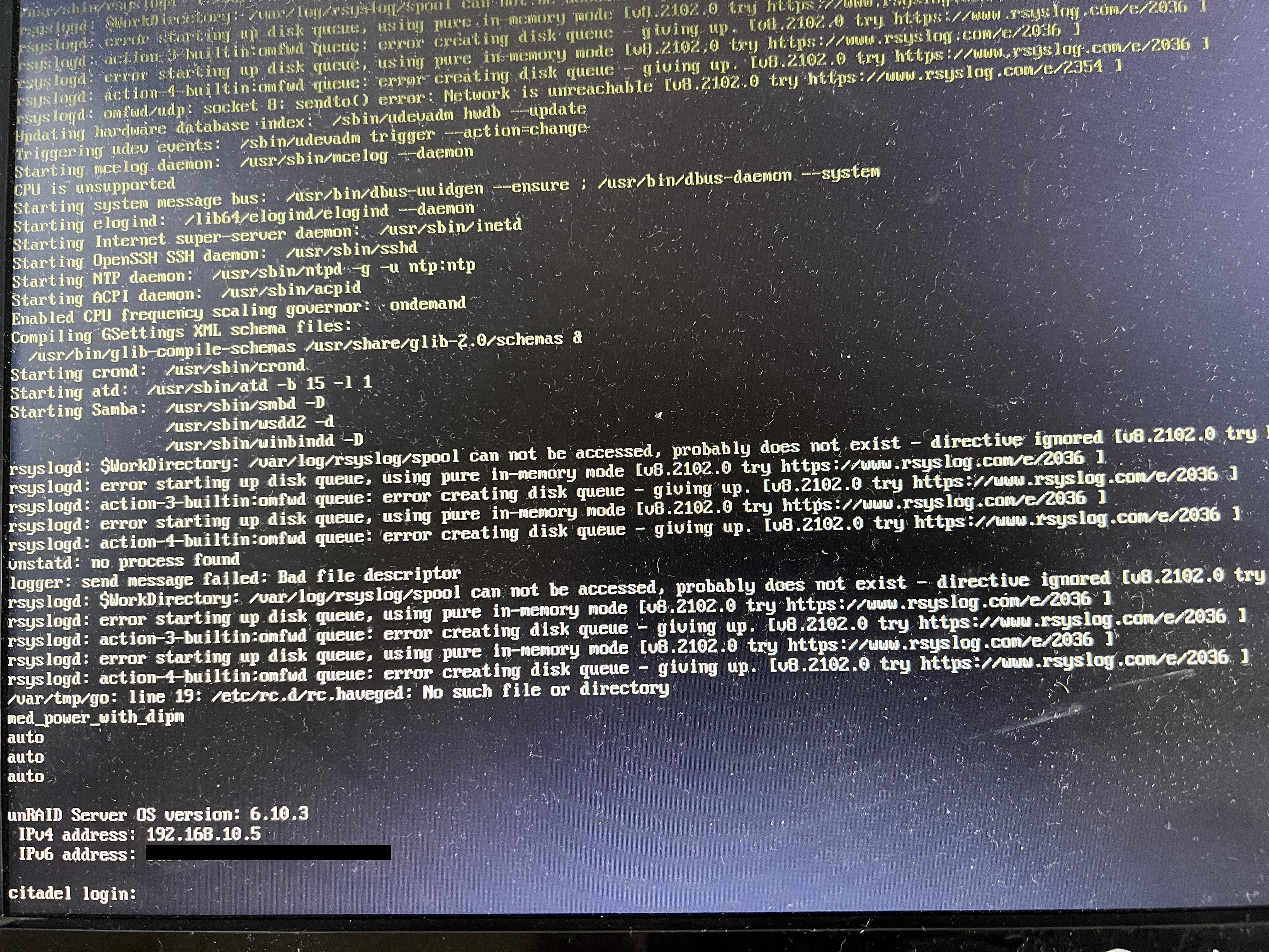

The latest "hang" today with whole boot process.
20220623-syslog-flashmirrorexport.txt
Not seeing anything related logged, did the server hang or you just lost LAN connectivity?
That is my problem. It is occurring randomly.
I have connected a display since boot now and will check if it appears again - just a matter of time.

Just after a little while, the system hang. Display shows as attached here but I cant make any input/login.
Also, I made the "ping test" again. Attached as well. First echo on second NIC came back. The system is also unresponsive over ipv6
Will reset now and revert back to Disable C-States & Power Gating enable.

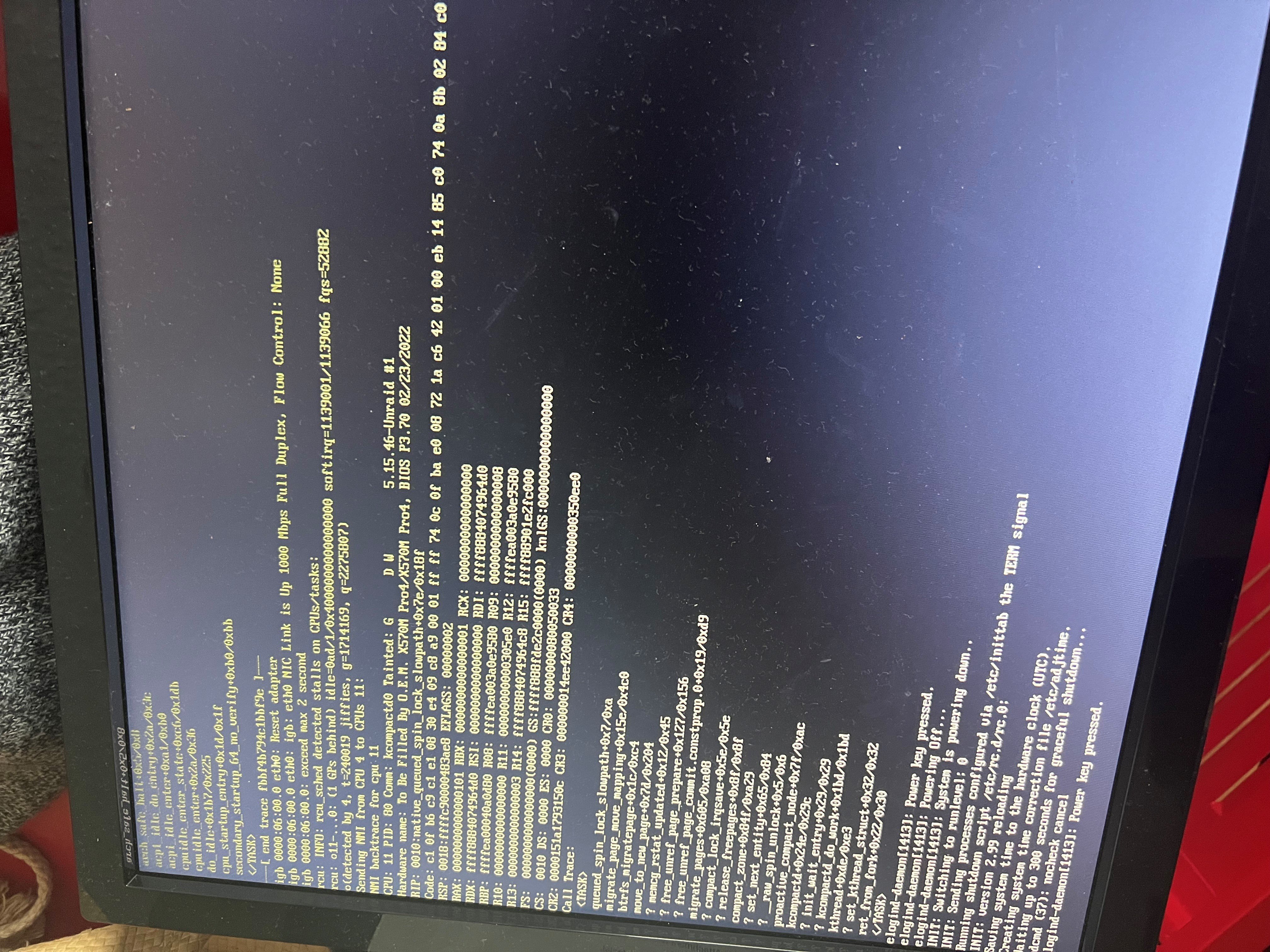

Okay, probably have something. This time, display showed something. May thats be a different issue / cause...
But no
Jun 24 20:30:01 citadel docker: RAM-Disk synced

Jun 24 20:46:33 citadel kernel: BUG: kernel NULL pointer dereference, address: 0000000000000088
Jun 24 20:46:33 citadel kernel: #PF: supervisor read access in kernel mode
Jun 24 20:46:33 citadel kernel: #PF: error_code(0x0000) - not-present page
Jun 24 20:46:33 citadel kernel: PGD 1526c9067 P4D 1526c9067 PUD 104273067 PMD 0
Jun 24 20:46:33 citadel kernel: Oops: 0000 [#1] SMP NOPTI
Jun 24 20:46:33 citadel kernel: CPU: 9 PID: 32715 Comm: shfs Not tainted 5.15.46-Unraid #1
Jun 24 20:46:33 citadel kernel: Hardware name: To Be Filled By O.E.M. X570M Pro4/X570M Pro4, BIOS P3.70 02/23/2022
Jun 24 20:46:33 citadel kernel: RIP: 0010:__mod_lruvec_state+0x13/0x44
Jun 24 20:46:33 citadel kernel: Code: 25 28 00 00 00 74 05 e8 0c 95 61 00 48 83 c4 10 5b 5d 41 5c 41 5d c3 0f 1f 44 00 00 41 55 48 63 d2 55 48 89 fd 49 89 d5 41 50 <48> 8b bf 88 00 00 00 89 74 24 04 e8 f1 08 fa ff e8 c7 c1 ff ff 8b
Jun 24 20:46:33 citadel kernel: RSP: 0018:ffffc90002f479d0 EFLAGS: 00010046
Jun 24 20:46:33 citadel kernel: RAX: 0000000000000000 RBX: ffffea00197c79c0 RCX: 000000000000000e
Jun 24 20:46:33 citadel kernel: RDX: 0000000000000050 RSI: 0000000000000013 RDI: 0000000000000000
Jun 24 20:46:33 citadel kernel: RBP: 0000000000000000 R08: 0000000000000013 R09: ffff88901e2fc000
Jun 24 20:46:33 citadel kernel: R10: ffffc90002f47a40 R11: 0000000000000286 R12: 0000000000000001
Jun 24 20:46:33 citadel kernel: R13: 0000000000000050 R14: ffffc90002f47ac0 R15: 0000000000000001
Jun 24 20:46:33 citadel kernel: FS:  0000147f12a0b640(0000) GS:ffff888fde240000(0000) knlGS:0000000000000000
Jun 24 20:46:33 citadel kernel: CS:  0010 DS: 0000 ES: 0000 CR0: 0000000080050033
Jun 24 20:46:33 citadel kernel: CR2: 0000000000000088 CR3: 00000001011dc000 CR4: 0000000000350ee0
Jun 24 20:46:33 citadel kernel: Call Trace:
Jun 24 20:46:33 citadel kernel: <TASK>
Jun 24 20:46:33 citadel kernel: __mod_lruvec_page_state+0x65/0x70
Jun 24 20:46:33 citadel kernel: ? __mod_lruvec_page_state+0x65/0x70
Jun 24 20:46:33 citadel kernel: ? __add_to_page_cache_locked+0x1cb/0x296
Jun 24 20:46:33 citadel kernel: ? lruvec_page_state+0x36/0x36
Jun 24 20:46:33 citadel kernel: ? add_to_page_cache_lru+0x56/0xbb
Jun 24 20:46:33 citadel kernel: ? pagecache_get_page+0x1ac/0x1ff
Jun 24 20:46:33 citadel kernel: ? prepare_pages+0x77/0x143
Jun 24 20:46:33 citadel kernel: ? btrfs_buffered_write+0x2cc/0x5ec
Jun 24 20:46:33 citadel kernel: ? btrfs_file_write_iter+0x2d0/0x360
Jun 24 20:46:33 citadel kernel: ? do_iter_readv_writev+0x99/0xdc
Jun 24 20:46:33 citadel kernel: ? do_iter_write+0x81/0xc2
Jun 24 20:46:33 citadel kernel: ? iter_file_splice_write+0x143/0x2e5
Jun 24 20:46:33 citadel kernel: ? pipe_read+0x300/0x327
Jun 24 20:46:33 citadel kernel: ? do_splice+0x3a1/0x4ad
Jun 24 20:46:33 citadel kernel: ? __do_sys_splice+0x14e/0x1e8
Jun 24 20:46:33 citadel kernel: ? do_syscall_64+0x83/0xa5
Jun 24 20:46:33 citadel kernel: ? entry_SYSCALL_64_after_hwframe+0x44/0xae
Jun 24 20:46:33 citadel kernel: </TASK>
Jun 24 20:46:33 citadel kernel: Modules linked in: ipvlan xt_nat xt_tcpudp veth xt_conntrack nf_conntrack_netlink nfnetlink xt_addrtype br_netfilter xfs ip6table_nat nfsd auth_rpcgss oid_registry lockd grace sunrpc md_mod nct6775 hwmon_vid efivarfs iptable_nat xt_MASQUERADE nf_nat nf_conntrack nf_defrag_ipv6 nf_defrag_ipv4 wireguard curve25519_x86_64 libcurve25519_generic libchacha20poly1305 chacha_x86_64 poly1305_x86_64 ip6_udp_tunnel udp_tunnel libchacha ip6table_filter ip6_tables iptable_filter ip_tables x_tables igb amdgpu amd64_edac edac_mce_amd gpu_sched drm_ttm_helper ttm drm_kms_helper drm agpgart kvm_amd kvm crct10dif_pclmul wmi_bmof crc32_pclmul crc32c_intel ghash_clmulni_intel aesni_intel crypto_simd cryptd rapl syscopyarea k10temp i2c_piix4 ccp nvme sysfillrect input_leds ahci i2c_algo_bit sysimgblt led_class tpm_crb fb_sys_fops libahci i2c_core nvme_core tpm_tis tpm_tis_core video tpm backlight wmi button acpi_cpufreq [last unloaded: igb]
Jun 24 20:46:33 citadel kernel: ---[ end trace fbbf4b794c1bbf9d ]---

Added a picture and used OCR to extract the Logs, may check later if OCR was with useable output as I am a little in hurry.
It says about eth0, which is the "primary" NIC.

I throw in a collection of panics I got (OCR extracted, may does have some false recognized chars):
cpu_startup_entry+Ox1d/Ox1f
sccondary_startup_64_no_verify+Oxb0/Oxbb
</TASK>
-L end trace fbbf4b794c1bbf9e l-
igb 0000:06:00.0 etho: Reset adapter
igb 0000:06:00.0 etho: igb: etho NIC Link is Up 1000 Mbps Full Duplex, Flow Control: None
igb 0000:06:00.0: exceed max 2 second
reu: INFO: rou _sched detected stalls on CPUs/tasks:
rou: 011-. . .0: (1 GPs behind) idle-Oad/1/0x4000000000000000 soft iry=1139001/1139066 fqs=52882
o(detected by 4, t=240019 jiffies, g=1714169, q=2275007)
Sending NMI from CPU 4 to CPUs 11:
NMI backtrace for cpu: 11
5.15.46-Unraid 11
CPU: 11 PID: 80 Comm: kcompactd0 Tainted: G
RIP: 0010: native _queued _spin_lock_slowpath+0x7e/0x18f
