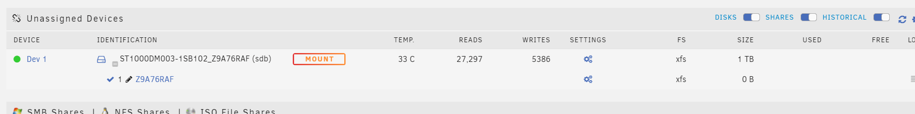

That's a good sign, it found a backup superblock, now mount the disk with the UD plugin (or add a new pool and assign it there) and check contents.
Great News 🎉!
I've never done that before. Should I mount it there using the button "MOUNT"?
Edited by manrw

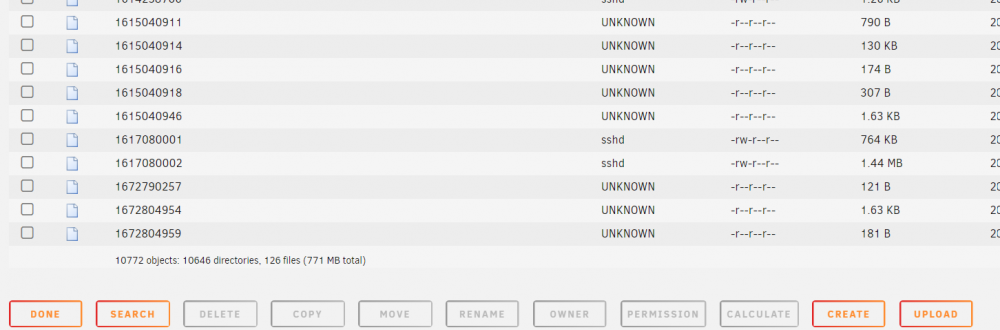

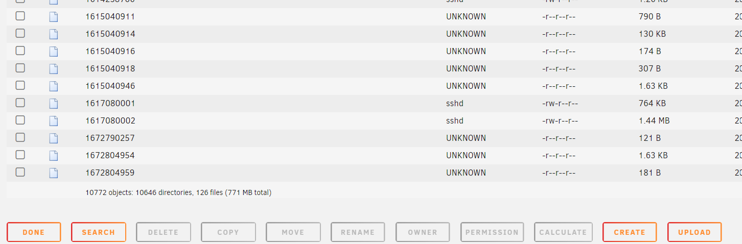

I clicked on "MOUNT" and checked "/mnt/" for contents.
This is what I can see:
There is a ton of these random directories with files in it
That's not unexpected, there will be some damage, you can inspect those files to see if there's something useful, other alternative is scanning the disk with a file recovery util like UFS explorer.
