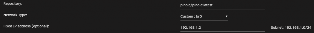

July 4, 20224 yr In diag 0913 ( and diag 0929 ) almost same figure, there are many dropped. My two 7x24 Unraid less then ten. In first, I ask what is the purpose of br0.30, if according TX packets only 5, it seems no usage of that VLAN, otherwise it should be dropped in RX side. What purpose of VLAN 30 ? What network mode setting in your Pihole docker ? Bridge ? I also apply Pihole for DNS resolve for whole network, but I like use Custom mode with fixed IP assign to it. I also apply VALN in my network, I found the best way to serve all VLAN DNS service is setting standalone subnet with stanalone VLAN, then enable internal routing for it for DNS resolve. I will suggest you - Connect eth_1 to your switch and assign a stanalone VLAN to it. ( Untag VLAN ) - Set it in different subnet in Unraid - Enable routing for different VLAN to access it. - Setting Pihole docker use eth_1 Last, I can't reproduce below problem in your other post, no matter array start or stop. On 11/30/2020 at 9:42 AM, xxbigfootxx said: ARP testing below. First is with Array Stopped arp -a took too long to load. arp -an was instant. curl was slow by successfull Second Image is Array Started arp -a slow but successfull arp -an instant curl failed as you can see. br0: flags=4163<UP,BROADCAST,RUNNING,MULTICAST> mtu 1500 inet 192.168.1.14 netmask 255.255.255.0 broadcast 0.0.0.0 ether 0c:c4:7a:a5:1c:88 txqueuelen 1000 (Ethernet) RX packets 18214924 bytes 28761832768 (26.7 GiB) RX errors 0 dropped 546 overruns 0 frame 0 TX packets 14030236 bytes 19836832054 (18.4 GiB) TX errors 0 dropped 0 overruns 0 carrier 0 collisions 0 br0.30: flags=4163<UP,BROADCAST,RUNNING,MULTICAST> mtu 1500 ether 0c:c4:7a:a5:1c:88 txqueuelen 1000 (Ethernet) RX packets 434838 bytes 26594699 (25.3 MiB) RX errors 0 dropped 392368 overruns 0 frame 0 TX packets 5 bytes 414 (414.0 B) TX errors 0 dropped 0 overruns 0 carrier 0 collisions 0 eth0: flags=4419<UP,BROADCAST,RUNNING,PROMISC,MULTICAST> mtu 1500 ether 0c:c4:7a:a5:1c:88 txqueuelen 1000 (Ethernet) RX packets 1686790108 bytes 2044847203423 (1.8 TiB) RX errors 0 dropped 12948 overruns 0 frame 0 TX packets 859426555 bytes 65710196914 (61.1 GiB) TX errors 0 dropped 0 overruns 0 carrier 0 collisions 0 Edited July 4, 20224 yr by Vr2Io
July 5, 20224 yr Author VLAN 30 is for my security cameras/software. I have Blue Iris running in a VM (via Unraid) with a 192.168.30.x IP. Maybe the VLAN definition isn't necessary in Unraid then? Pihole is on a custom br0 network. This is the same IP range as my default untaged VLAN that houses all of my main devices. I have separate VLANs for IOT items and security cameras. I'll have to see if I have another open port on my switch. I didn't think I'd use an eight port switch up quickly but it's full or all but. If I do, I'll try the suggestion above by putting Pihole on it's own VLAN. This is how I currently have my untaged VLAN set to resolve for the Pihole in the Networks section of Unifi Control.

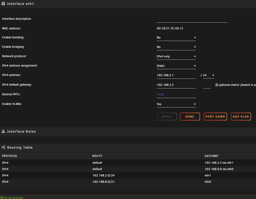

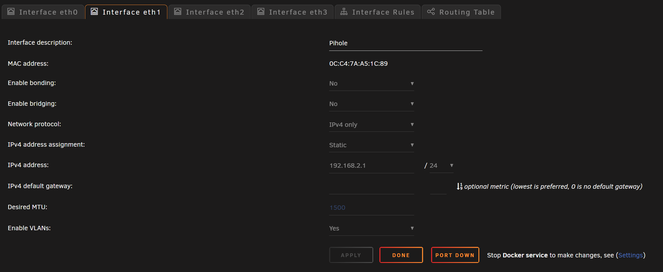

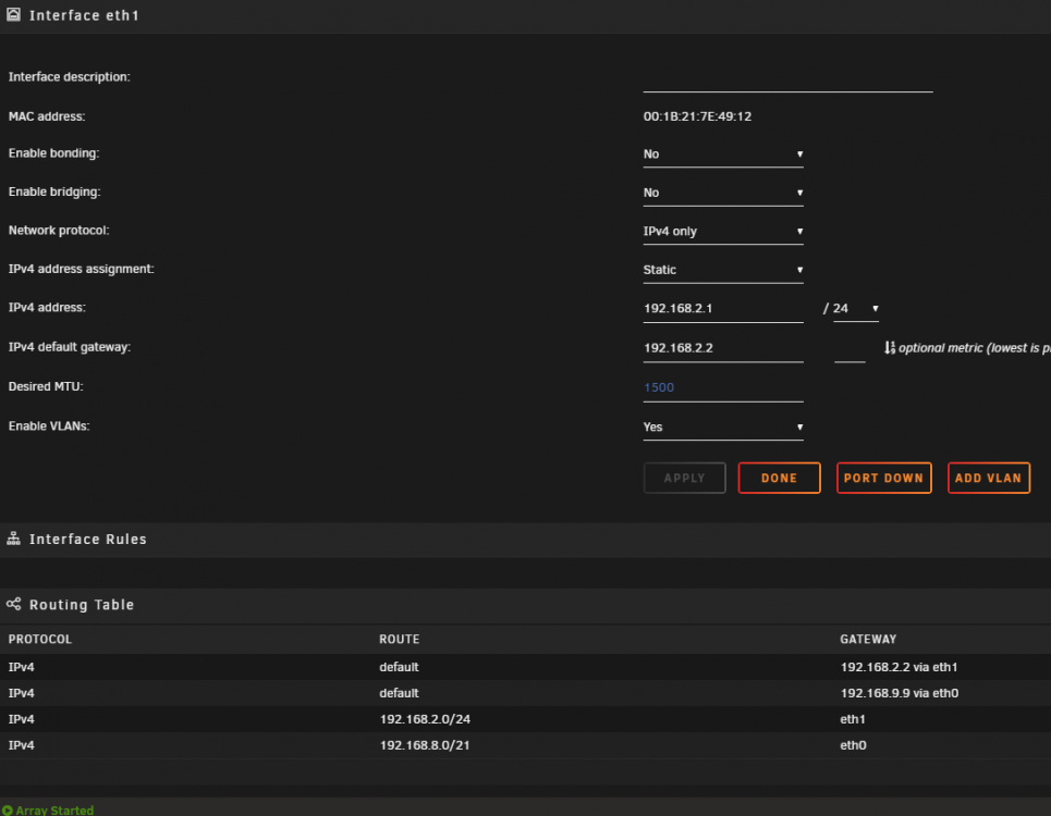

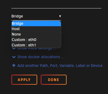

July 10, 20224 yr Author I cannot figure out how to get the Pihole docker on eth1. I connected it to my router and set it up in Unraid. I tried it with and without bridging, with and without a default gateway, and with and without a VLAN (which matches a VLAN I created in the Unifi controller). I see stuff in the Routing Table pertaining to the eth1 interface. Do I need to also create a custom docker network titled br1 that is an ipvlan type with the 192.168.2.1 info in it? Or should I create a new VLAN on eth0 for it instead of a separate network interface? I'm not sure what the difference would be. Edited July 10, 20224 yr by snowborder714

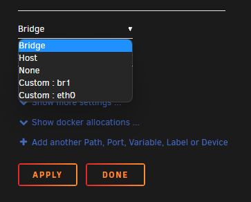

July 11, 20224 yr 13 hours ago, snowborder714 said: I cannot figure out how to get the Pihole docker on eth1. I connected it to my router and set it up in Unraid. I tried it with and without bridging, with and without a default gateway, and with and without a VLAN (which matches a VLAN I created in the Unifi controller). With a static IP set in default gateway, then you will got eth1 / br1 in pull down menu.
July 11, 20224 yr Author Not sure how I missed that when I tried it the first time! Thanks for the help on that. Hopefully I can get this wrapped up soon to see if it helps.
July 25, 20224 yr Author So far, this has fixed the problem! I'll keep an eye on it for a bit more and update again. I really appreciate the suggestion/help @Vr2Io!

August 8, 20224 yr The problem is it route internet traffic use eth1 but can't got response from gateway 192.168.10.1 You may try edit the metric ( Unraid network setting ) of the default route ( eth1 ) be lower priority then eth0 or delete eth1 default route. Edited August 8, 20224 yr by Vr2Io

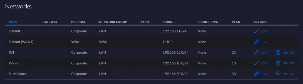

August 8, 20224 yr Not too family USG, but all subnet haven't show the gateway, pls also review that. Expect each subnet have their gateway i.e. 192.168.1.1, 192.168.25.1, 192.168.10.1 etc ....... you may click EDIT to check. You may need entry the subnet in 192.168.1.1/24 instead 192.168.1.0/24
