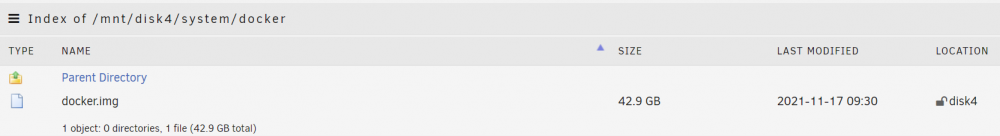

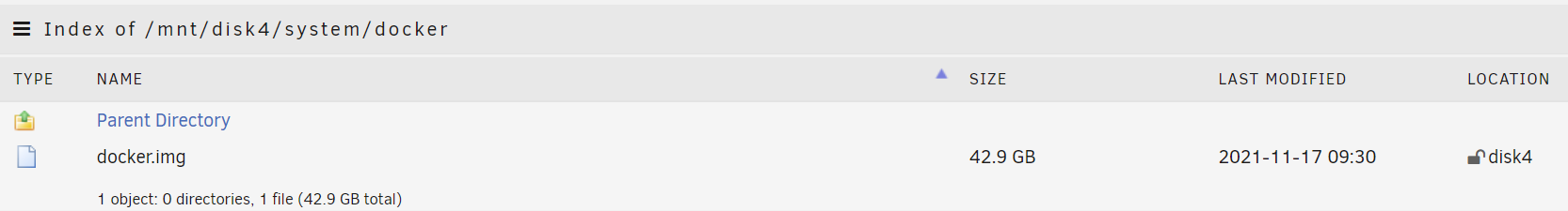

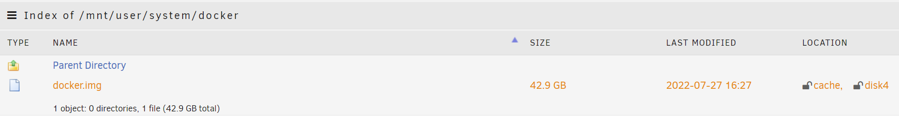

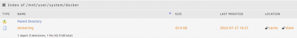

Not sure why but I've got two docker.img files, one sitting on the cache drive and one on the array disk4.  Last modified date of the disk4 file is back in Nov2021 which suggests its no in use.
How can I resolve this issue & end up with one docker.img file on the cache ? (Without having to rebuild the containers).  Thanks

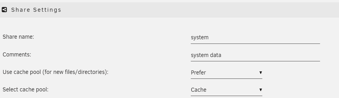

I tried changing system share setting Use Cache Pool from pefer to yes, stoping docker & invoking mover but no change.

Delete the file manually, on the console type:
rm /mnt/disk4/system/docker/docker.img
Probably you enabled docker when you didn't have cache for some reason.
Fortunately not. Nothing can move open files, mover won't move duplicates, and you didn't want it to do that anyway since it would try to move TO the array.
You can delete as mentioned, but wonder if you don't have other things needing fixing, like appdata with files on the array for example.
