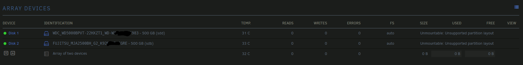

I'm new to Unraid, and I wanted to setup an NAS. The Problem is that my Drives are unmounted. So how do I mount them? I have already Zeroed out all my hard drives, and read a lot of the forum. I dont get it working, can anybody help me?

If you haven't formatted the disks in the array yet then they have no filesystem to mount.
Assuming these disks have no data yet, go to Array Operation and format them.

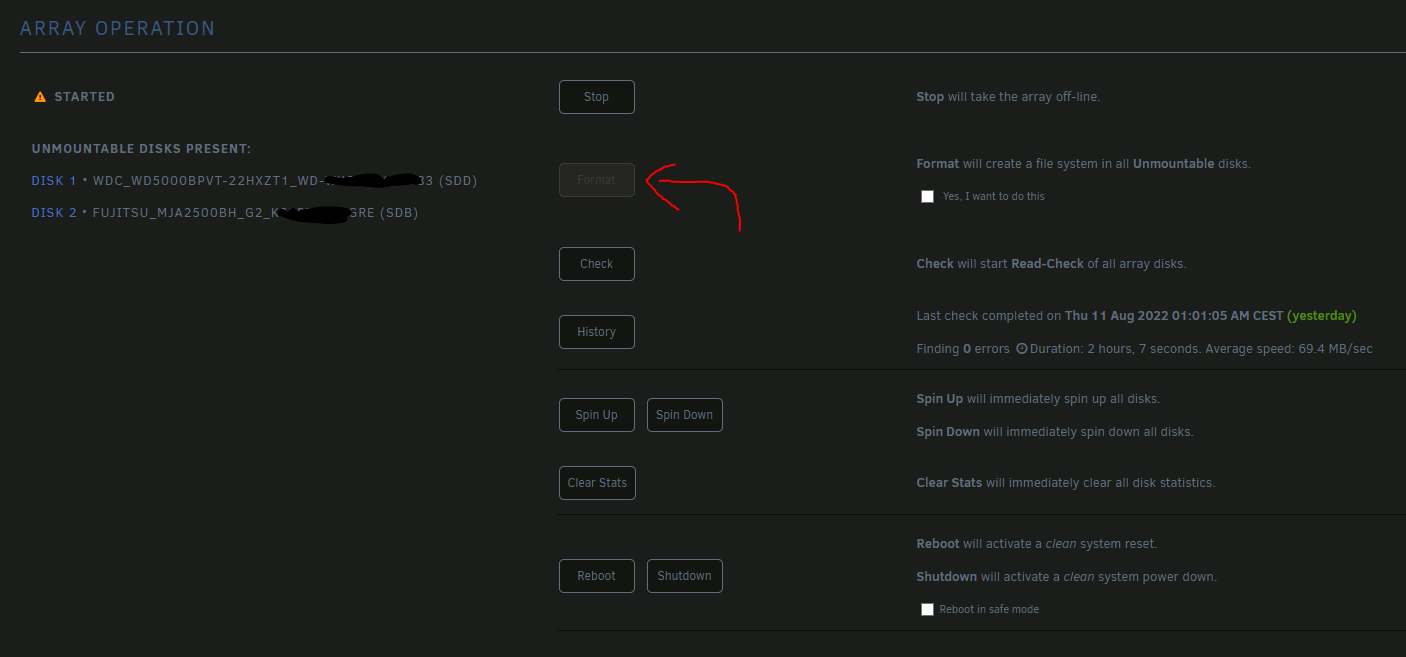

thanks, but unfortunately the option is grayed out.
Perfectly normal. Check the box that acknowledges "Yes, I want to do this" and it will become available.
We make it a multi step process to format drives because too often if someone has file system corruption the first thing they want to do is format the drive to make it mountable and then they think parity will restore their files, when the correct thing to do is a file system check. Formatting replaces the table of contents with a blank version, and it effects the parity drive as well, so it makes recovering data much harder or impossible.
In your case, you genuinely DON'T have a valid filesystem yet, so check the box and apply the format.

Thank you, its working now!
