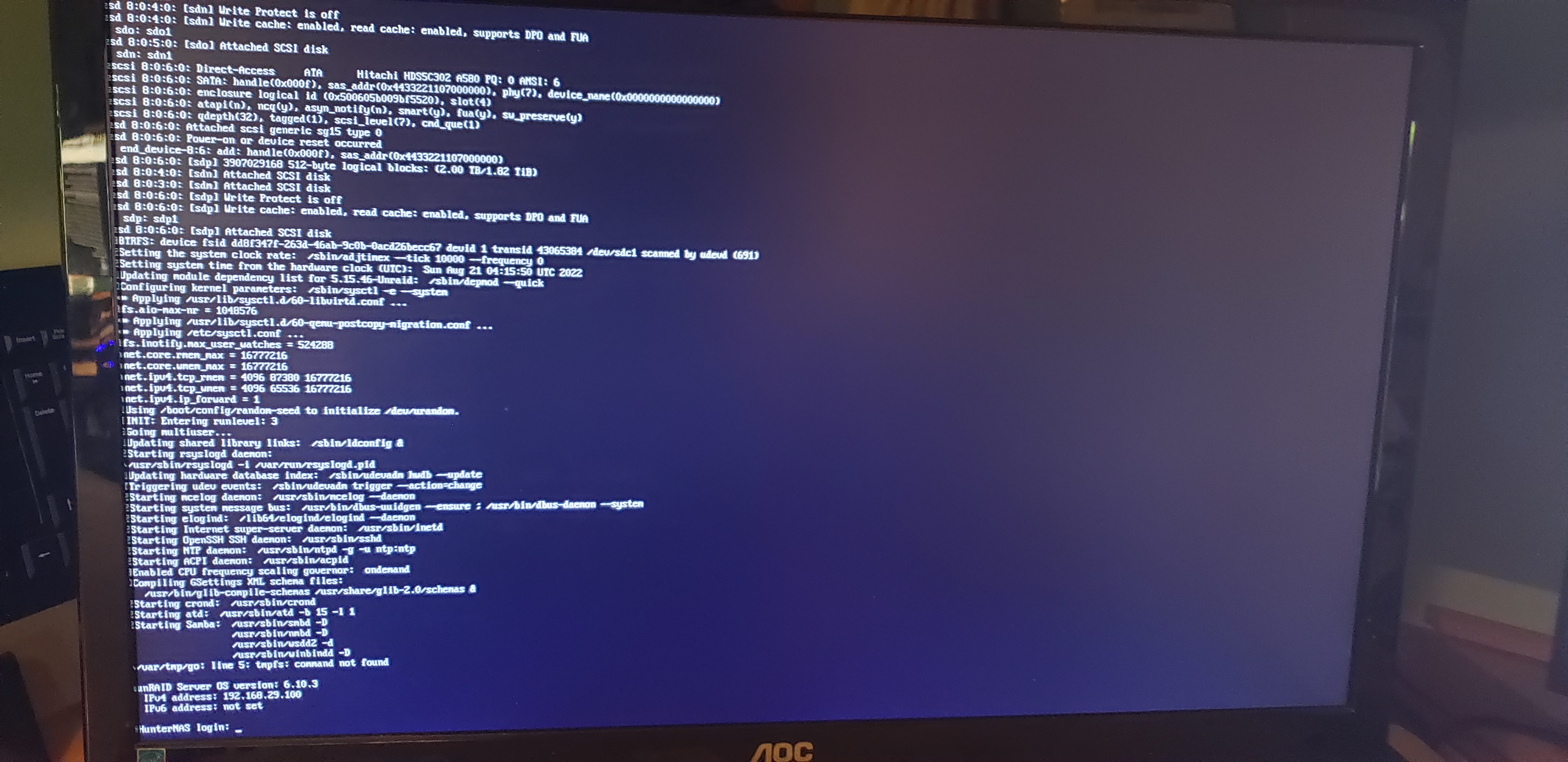

Then as the status lines started to display, its all gibberish (see image).
I then shutdown and turned off the pc (turned off power supply), then rebooted again.  This time got past BZimage and BZRoot, displayed readable characters this time, but as the last few lines of the boot process showed, the display reset and changed the display mode (132 character mode - see screenshot).  Still readable, but never seen that before either.

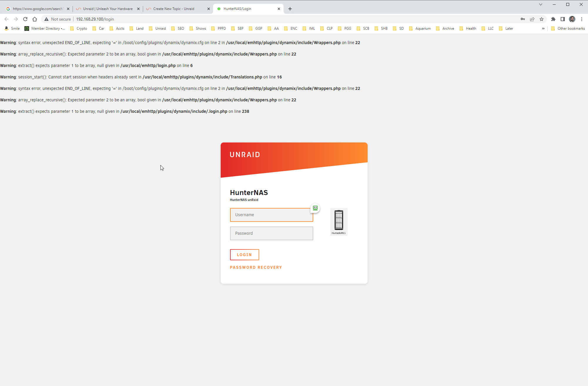

Then I started the WebUI and the following displayed above the login (see third screenshot):
Warning: syntax error, unexpected END_OF_LINE, expecting '=' in /boot/config/plugins/dynamix/dynamix.cfg on line 2 in /usr/local/emhttp/plugins/dynamix/include/Wrappers.php on line 22

My regular webui login was accepted, but then the same error message was displayed on the screen.

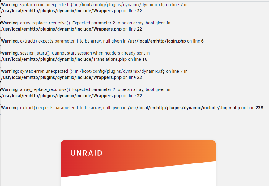

I'm completely new to Unraid but just did my first reboot and have got the exact same errors as you (although I don't have 'garbled' text on the boot up window).

It would appear that you flash drive has major corruption on it.  Does deleting everything from /config on the flash drive (except for the .key file and super.dat) fix things up? (Ideally, make a backup of it first)

Unfortunately this didn't work. It just reset the name to Tower and removed my fixed IP address.
However, I just copied my saved backup over the USB and it's working again. I didn't realise I could just copy the files directly on to the USB - I had presumed there was some fancy fomatting or 'hidden' files or something going on.

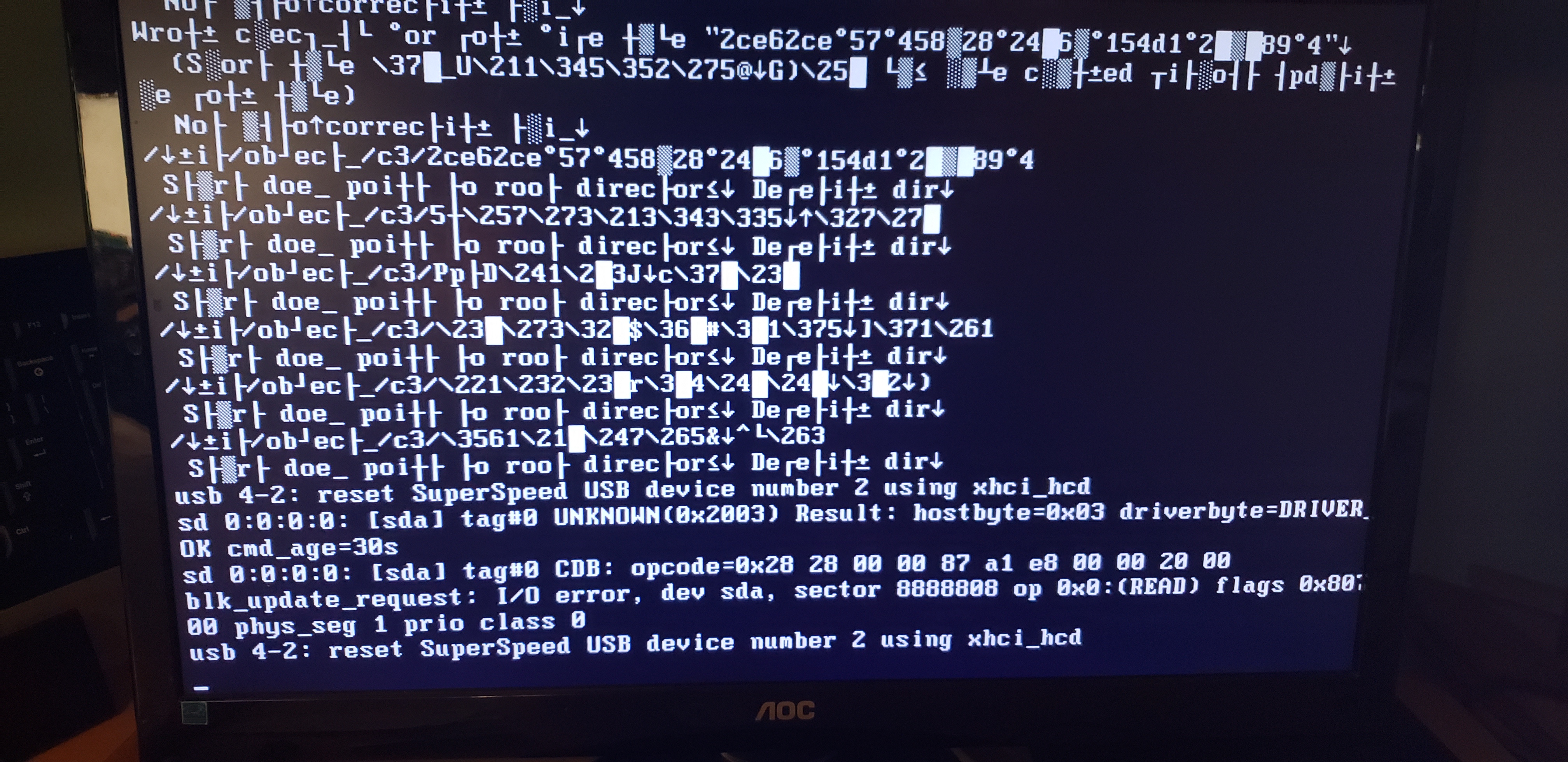

When I went to clean out the drive, I see 23 FSCKxxxx.rec files.  Assume these are lost sectors?  Evidenced by the fact that I can't actually copy/backup the flash drive.
