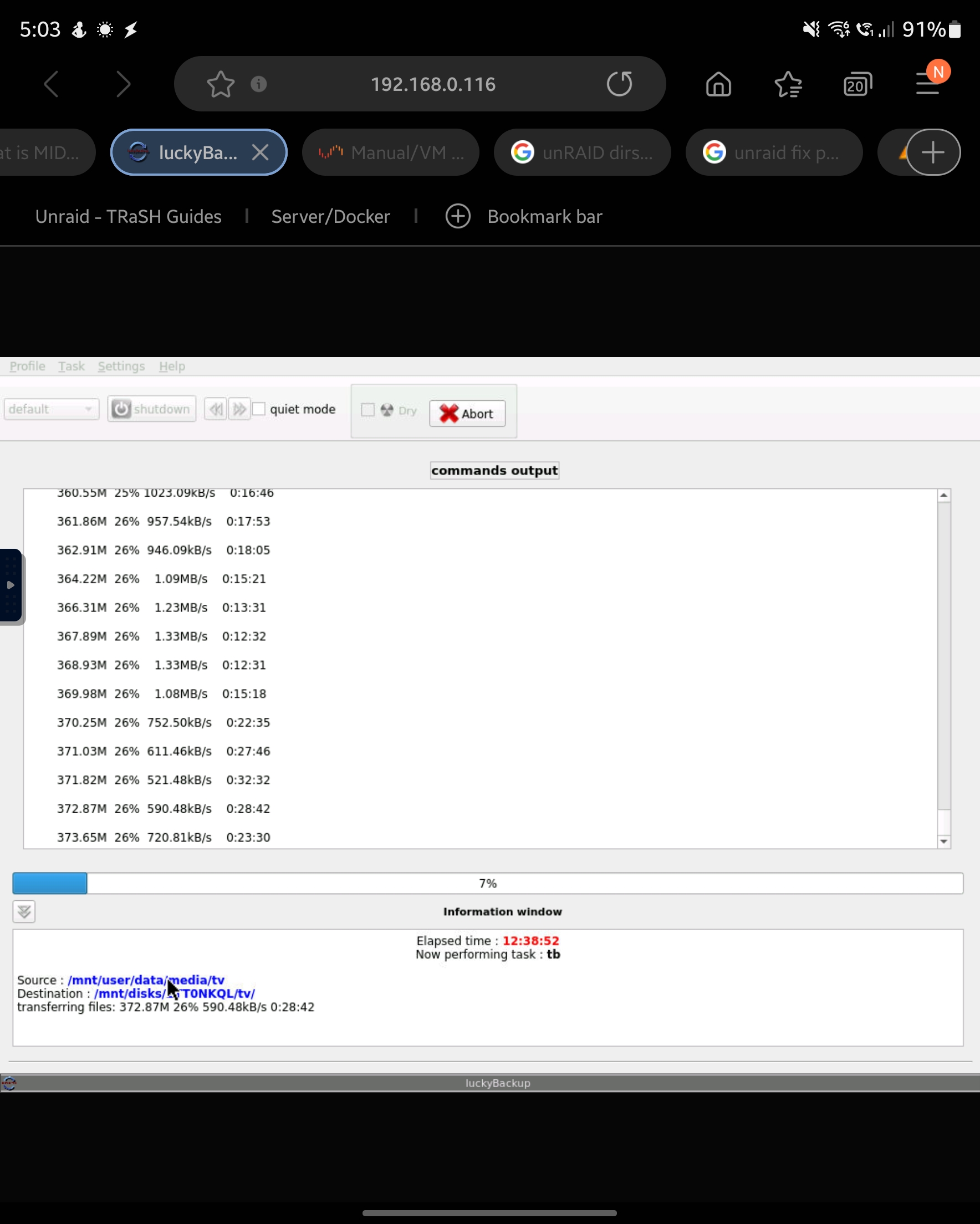

I'm in the process of moving heaps of stuff off my unRAID server. At the moment I'm trying to copy my tv shows from my media share to a USB 3 external drive. The issue is that occasionally I get good transfer speeds, but most of the time the speed is appalling! I just took a screenshot of my current transfer using Luckybackup.
1113095716_Screenshot_20220821-170347_SamsungInternet.thumb.jpg.a2ae301b21616d0b83630bcd41195c54.jpg
I've tried Krusader and I have the same issue. I decided to try and stick it out with Luckybackup because I'd read that it uses rsync and that apparently using rsync helps.

Seems you transfer those files in parallel, you should set it in one by one.

From your screenshot, we can see several transfers at ~26% and between 1.5MB to 500kB/s.
That's the slow progress of the same large file from what I can see.
That's correct.
Initially it was transferring close to 200MB, but I haven't seen that sort of speeds for a long time.
Am I probably correct in assuming that the issue is with the actual external drive?
It does seem quite likely. Are you copying a really large amount of data, and is it an SMR drive?
