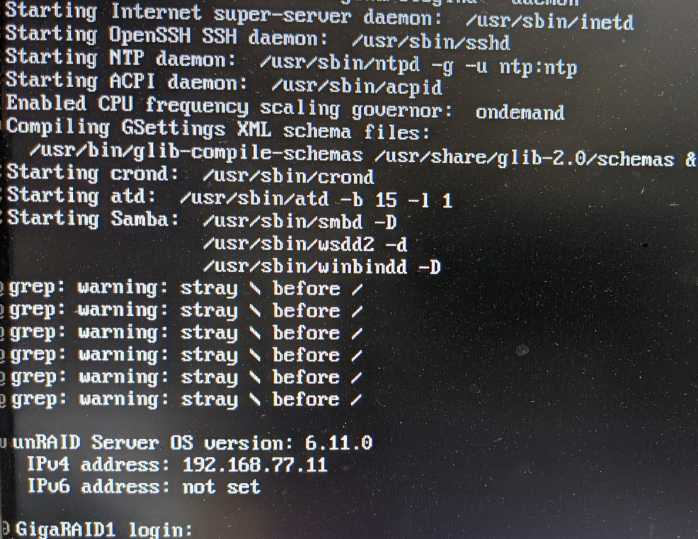

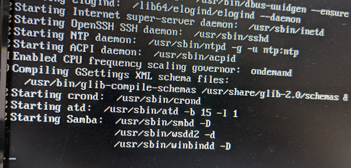

At boot the system 'hangs' here at `starting samba` for 3-4mins
Then comes up with this `grep: warning: stray \ before /`

  - My Servers
and am still getting the 3 to 4 minute wait at 'Starting samba' BUT no grep warnings
Is this normal wait time, or is there still an issue?
The plugin causing the grep warnings was Theme Engine
Yes, that can be normal.
