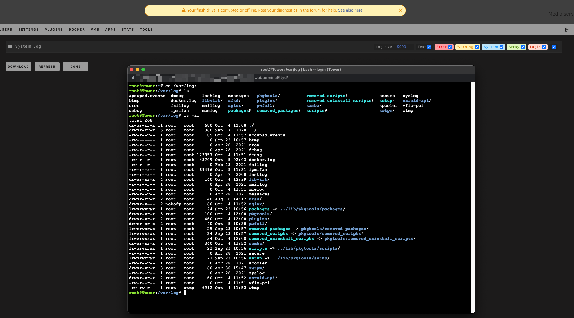

@trurl- Shows blank there too. Even `/var/log/syslog` is blank with a last update in 2021:

I just attempted to re-install unraid on the same flash drive, and copy over the `config` directory, but still getting the same error. Syslog is still blank too.

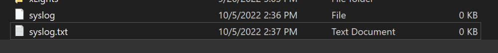

Copy the syslog to a share you can access over the network then attach it here, e.g.:
cp /var/log/syslog /mnt/user/share_name/syslog.txt
@JorgeB Thanks for the suggestion, although I'm not sure what that'll show. It's a 0 byte file in /var/log/ (see above screenshot). I'm the root user, so I can access it, but did copy it to a share I have access to, and it's still empty/0 bytes:
