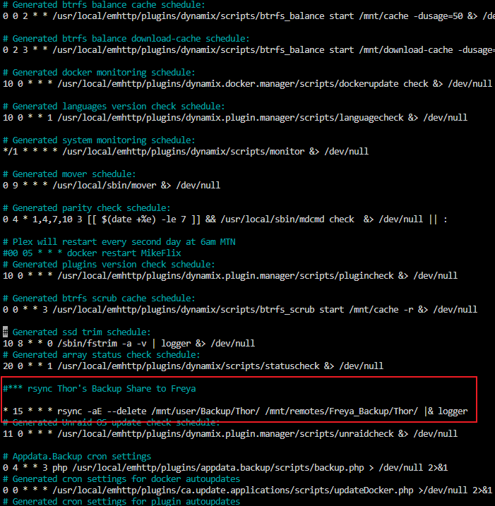

here is a screnshot of the the /etc/cron.d/root file
and maybe i using grep wrong but no results using the cron schedule with rsync command and its options (Attached too)

I would suggest searching the boot drive as indicated using 'Freya_Backup' as the search string as that looks unlikely to give many false positives.

found it!! thank you for your help
root@Thor:~# nano /etc/cron.d/root
grep -r "Backup Share to Freya" /boot/
/boot/config/plugins/dynamix/thor2freya.cron:#*** rsync Thor's Backup Share to Freya

Thanks so much for sharing your findings! Mine was placed there as well. I think this was the post I came across last time
 Finally, I can resolve it now.

found it under /boot/config/plugins/dynamix/thor2freya.cron
renamed it thor2freya.cron.old
I have other crons I created there I am going to remove
