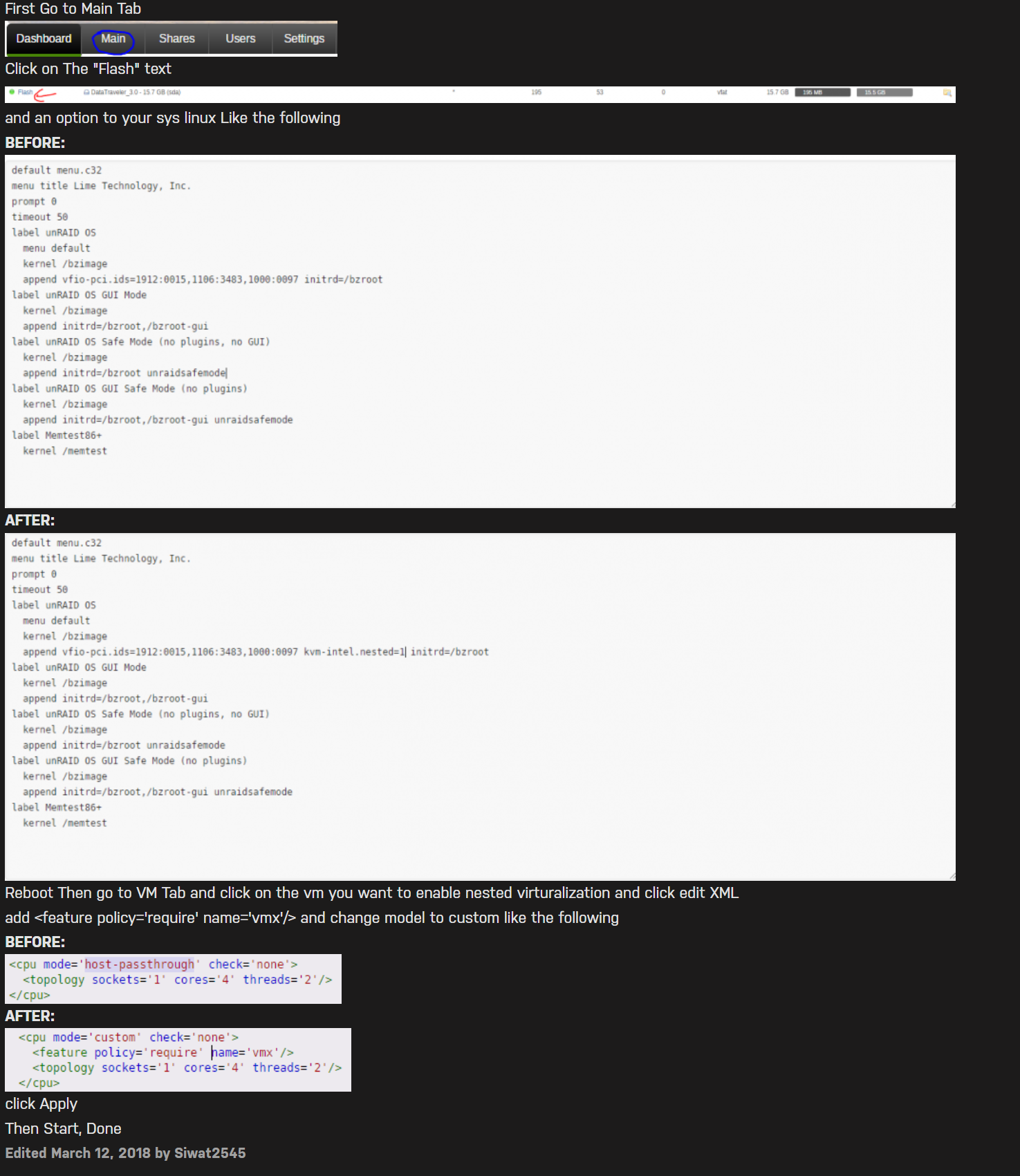

Did you enable nested option in syslinux settings and reboot?
Could you go into more detail here? I only have 1 year of and a bit unRAID under my belt 😛 But if you're asking if my unRAID install is running with nested on, it is. I'm running Windows 11 with Hyper-V.

What does you cpu support it? I mean adding kvm-intel.nested=1 in the syslinux as below. Not sure if it is required but was on the thread you specified, but I dont have enabled and could save XML.
In my case it's a 5950X but nested virtualisation is on as my above edit shows. That's the only reason why I can run Hyper-V on Windows 11 with no issues.
