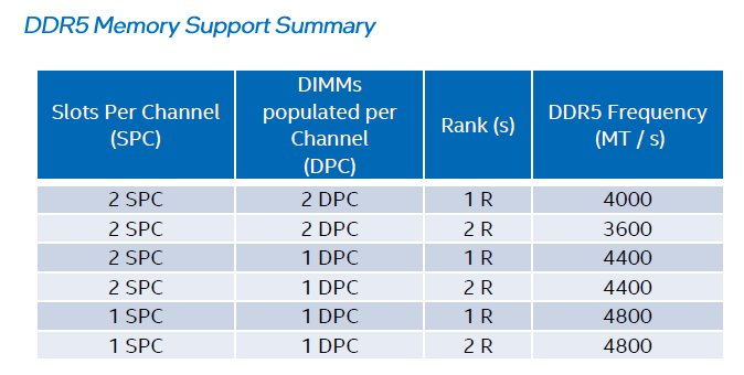

I was thinking of switching to an Intel-based system, is there a similar list for supported RAM configurations or is it mainly a Ryzen issue?
Intel usually specified the max speed with all sockets populated, so for example CPUs that support DDR4 3200 support it with 4 DIMMs, for Alder Lake with DDR5 this is no longer true:
Cannot find this table for Raptor Lake but I would assume there will also be limitations since max speed is now 5600 MT/s with DDR5
