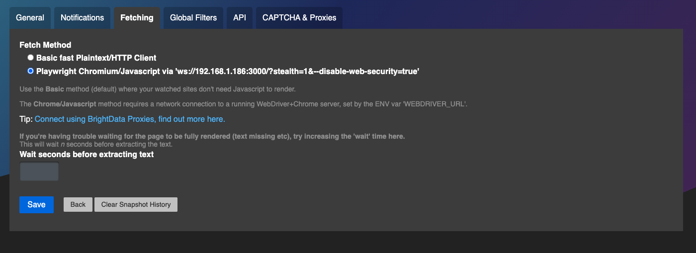

KillerVette42 Posted January 2, 2023 Share Posted January 2, 2023 In my changedetection.io docker, i get the error No module named 'playwright'. I have added PLAYWRIGHT_DRIVER_URL=ws://yourIP:yourPORT/?stealth=1&--disable-web-security=true as a variable in the docker settings for changedetection. Any ideas?? Quote Link to comment
PopRockRoll Posted January 3, 2023 Share Posted January 3, 2023 10 hours ago, KillerVette42 said: In my changedetection.io docker, i get the error No module named 'playwright'. I have added PLAYWRIGHT_DRIVER_URL=ws://yourIP:yourPORT/?stealth=1&--disable-web-security=true as a variable in the docker settings for changedetection. Any ideas?? Are you using the LinuxServer version? You have to pull it from the dgtlmoon docker hub image. 1 Quote Link to comment
Masterwishx Posted January 3, 2023 Author Share Posted January 3, 2023 (edited) On 1/2/2023 at 6:21 PM, KillerVette42 said: In my changedetection.io docker, i get the error No module named 'playwright'. I have added PLAYWRIGHT_DRIVER_URL=ws://yourIP:yourPORT/?stealth=1&--disable-web-security=true as a variable in the docker settings for changedetection. Any ideas?? Like @PopRockRoll said you should use official docker from dgtlmoon, Becouse Linuxserver Docker don't support playwright if I remember correctly. Edited January 3, 2023 by Masterwishx Quote Link to comment
KillerVette42 Posted January 3, 2023 Share Posted January 3, 2023 Perfect, thanks! 1 Quote Link to comment

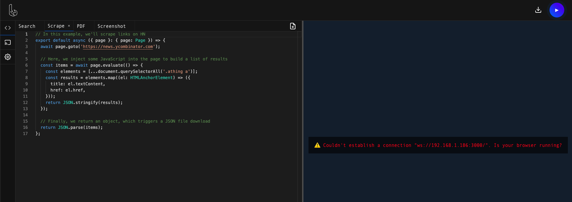

rainmanjam Posted February 14, 2023 Share Posted February 14, 2023 (edited) I'm getting an error when I connect through the GUI Couldn't establish a connection "ws://192.168.1.186:3000/". Is your browser running? But when I use changedetection.io and connect and use the connection. It works fine. Edited February 14, 2023 by rainmanjam Quote Link to comment
Masterwishx Posted February 14, 2023 Author Share Posted February 14, 2023 3 hours ago, rainmanjam said: I'm getting an error when I connect through the GUI Thanks for let me know ,checked and also have this problem, i think its after last update, i opened issue on they github. https://github.com/browserless/chrome/issues/3023 you can also write about error .... just change container to get version befor this or wait when they fix it ,if you really need the GUI.... 1 Quote Link to comment
Masterwishx Posted February 14, 2023 Author Share Posted February 14, 2023 @rainmanjam you can try change to browserless/chrome:1.53-chrome-stable for container this should work fine ... Quote Link to comment
Masterwishx Posted February 15, 2023 Author Share Posted February 15, 2023 @rainmanjam checked browserless/chrome:1-chrome-stable same as browserless/chrome:1.57-chrome-stable working fine in WebUI and they both pushed to dockerhub repo after latest ... Quote Link to comment
Masterwishx Posted February 18, 2023 Author Share Posted February 18, 2023 @rainmanjam checked the latest version for now and its working again in WebGui , please confirm if possible ... Quote Link to comment
