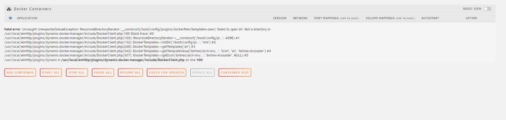

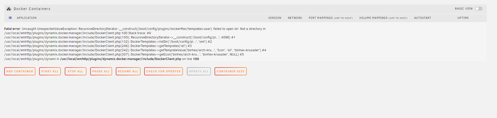

WELP, did the chkdsk (also deleted nderdpack) and now it looks like this (attachment).  All my dockers / apps are messed up now.
See new diagnoistics as well.
Time to remake the usb from a backup?  No idea whats going on now.  Seems like that made things worse.
