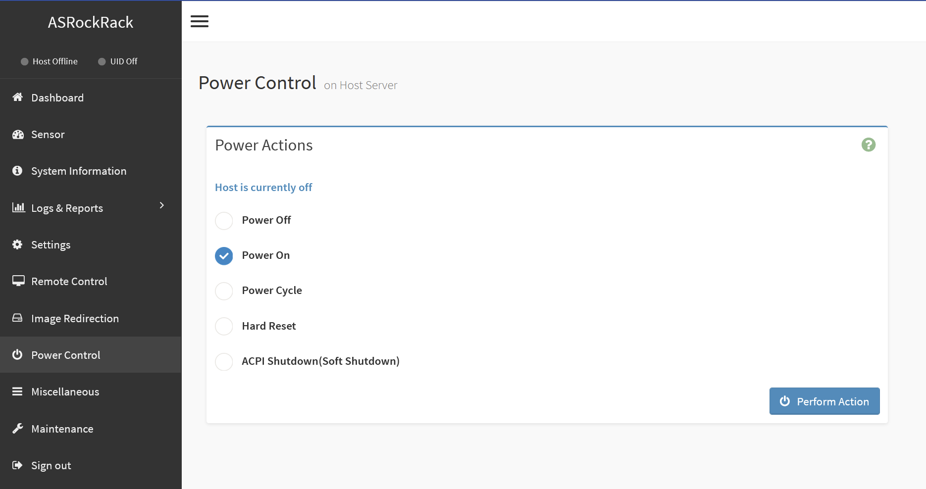

Since my server motherboard does have IPMI, I simply needed a way to access the server remotely when the server is down.  I already had a Raspberry Pi 3 B+ on my network running Pi-Hole and I thought "why not add WireGuard to it as well?"  I  did so following this guide. It was very easy and worked just as outlined.  I have successfully tested remote access to my server GUI and the IPMI admin page from my phone and laptop via WireGuard on the RPi.
IPMI is a wonderful thing for remote management.

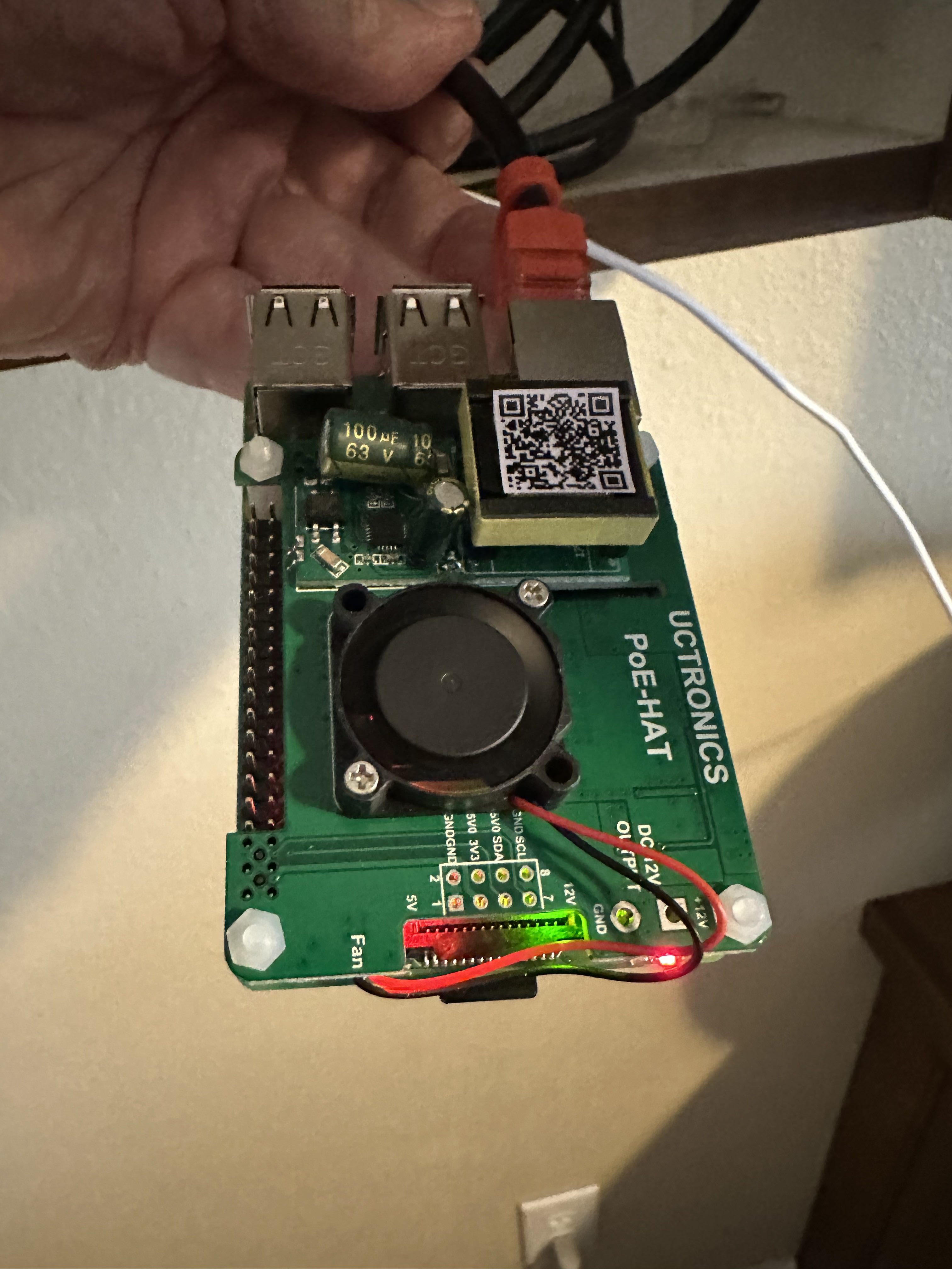

Taking it one step further, I decided I wanted to make sure the RPi also powered up automatically when power was restored so I installed a PoE (power over Ethernet) HAT (Hardware Attached on Top) on the Raspberry Pi.  This provides power to the device through the Ethernet cable.  No external power supply is needed.  There are many PoE HATs available but they are supported by the Pi 3 B+ and Pi 4 models only. They may also support different PoE standards.

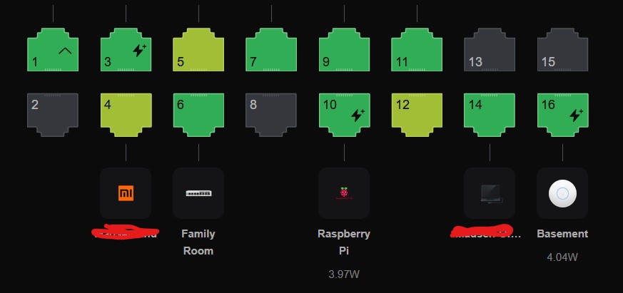

My Unifi switch supports PoE so I enabled it on the port to which the RPi is connected.  As seen below, it is drawing about 4 watts from the PoE switch.

Here is the RPi powered on with only an Ethernet cable connected to it:
Some Raspberry Pi power supplies, like mine, have a switch that requires the switch to be toggled in order to power on the unit.  Others will power it on automatically if it is plugged into the RPi and there is power.
PoE for me is simply more reliable.  If the switch has power, the RPi has power.
Since the PoE HAT I installed has a fan that is positioned right over the RPi CPU, the CPU temp has dropped 10C from where it used to be.  A nice added bonus.

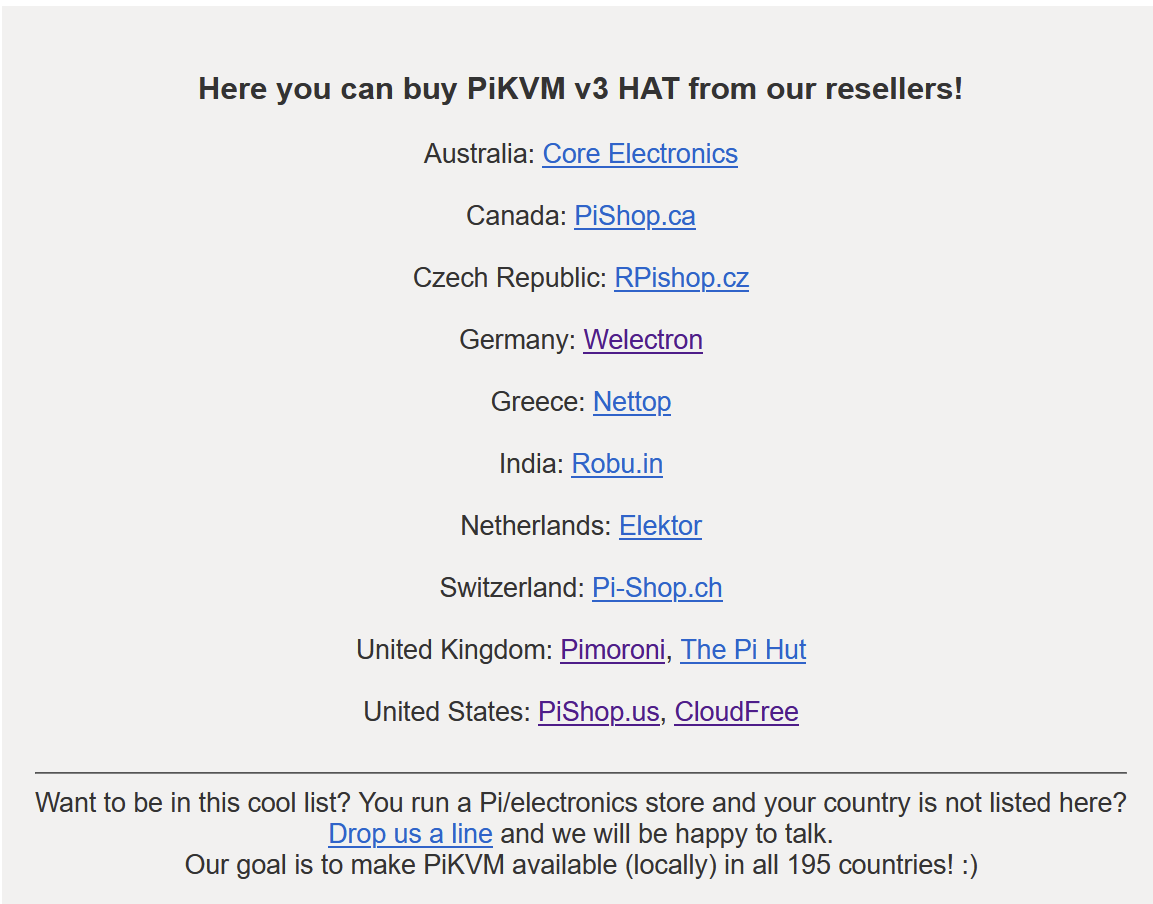

For those who may have an interest in the PiKVM, here is a list of international sellers:
