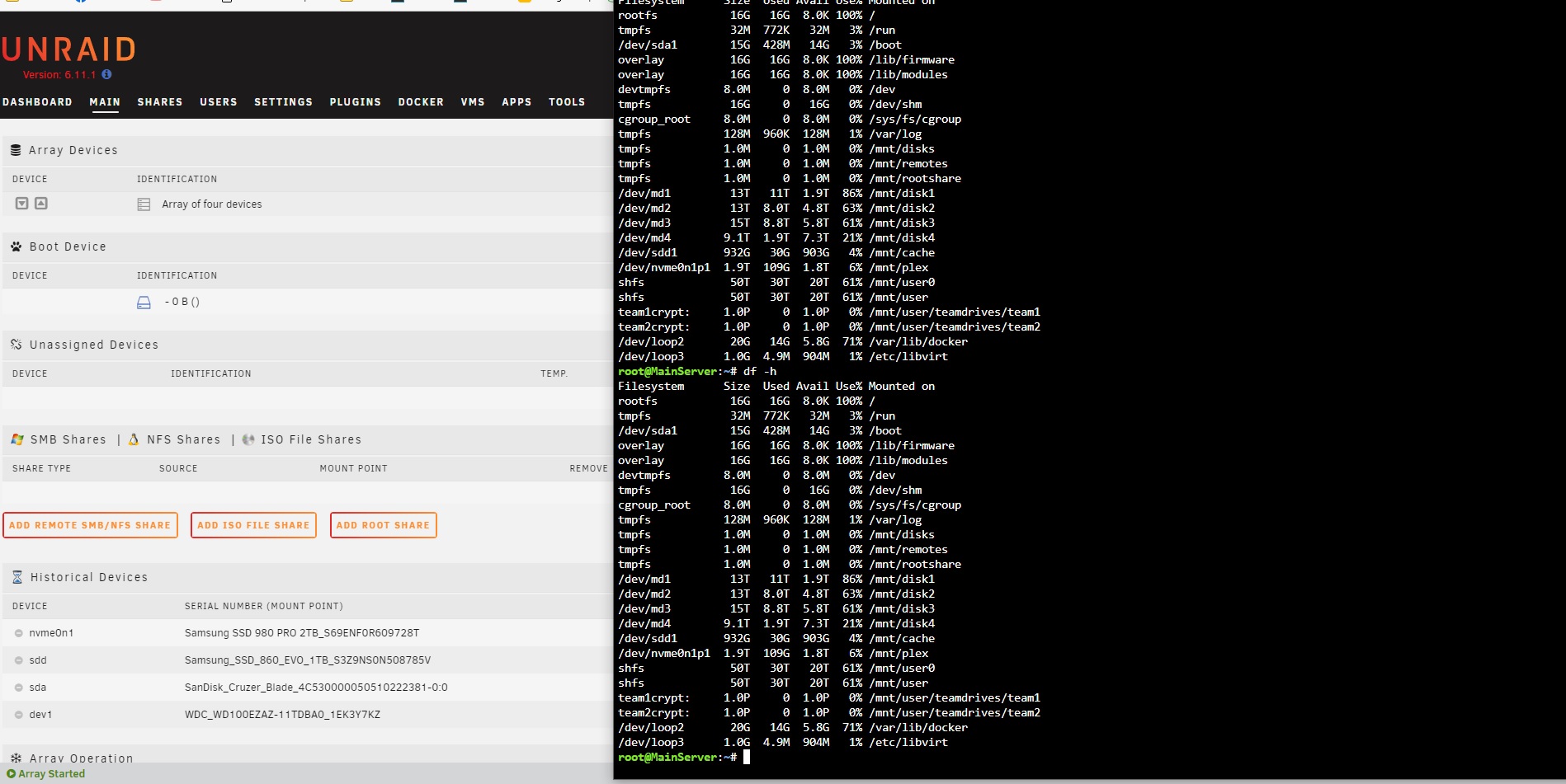

When you have problems getting diagnostics what do you get from the command line with this?
df -h

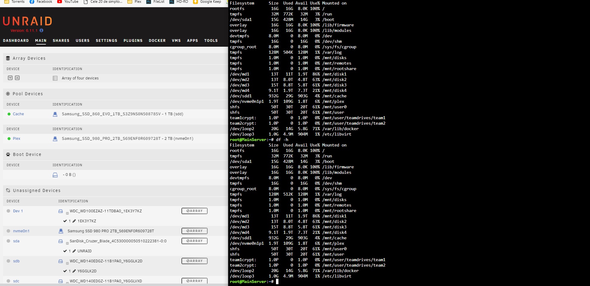

If i don't restart eventually it keeps getting my array offline/online every few seconds
You have completely filled rootfs, the space the OS runs in. When you fill rootfs, the OS will behave erratically and even crash since the OS no longer has any space to work in. Any path that isn't a path to a disk or user share is a path in rootfs. You need to figure out where you have specified a path in rootfs, perhaps a host path in one of your containers.
Reboot, disable Docker in Settings, then get diagnostics and attach to your NEXT post in this thread.
From what I see the moment I start Qbittorrent it starts filling in about 1 min to 100%
rootfs
/lib/firmware
/lib/modules
all with the same percentages. What could that be from?
Ok, I figured it out.
I was using Rclone to mount a drive with cache settings on and when qbittorrent was supposed to access it with cache it looks like it was filling up "rootfs".
After I mounted Rclone without the cache settings on, rootfs stopped filling up.
