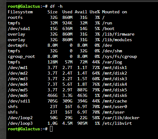

What do you get from command line with this?
df -h

That shouldn't cause diagnostics to fail, possibly you have filled rootfs somehow, which is why I asked
Looks like its not full.
The mover is still running.  I'll reboot after its finished and report back.
