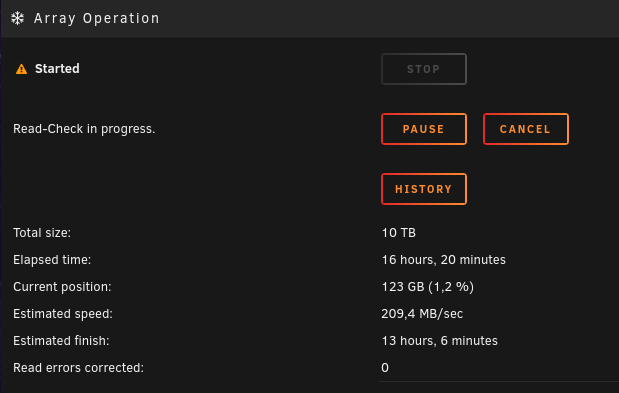

Yesterday the scheduled parity check started, which ran as a read-check because of the above.
It says its busy, but i cant stop it. The Cancel and Pause buttons are unresponsive.

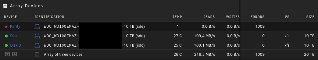

Its also showing the wrong amount 10 TB, should be 20 TB.
Its stuck at 123 GB for half a day now.
How can i stop the read-check, so i can enable (and rebuild) my parity drive?

Best bet is to reboot, see if you can get the diagnostics before doing it.
Already did the reboot, it helped. Sorry dont have a diagnostic.
10TB is correct ;)  The size reported is that of the parity drive, not the sum of the drives in the array.
