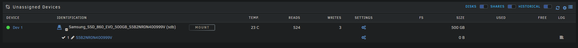

After doing so, it doesn't appear that anything has been transferred from the old cache pool device to the new one. My Docker/VMs are all missing.
Any advice on how to transfer these? Attached diagnostics. Currently the old cache drive is unassigned.
I have not touched anything yet because I'm pretty new to working with Unraid, only having had this machine up and running for about two weeks. I found the Unassigned Devices plugin and thought that could be helpful for mounting the drive and copying the contents of the old cache, but please correct me if there's a better/more correct way.

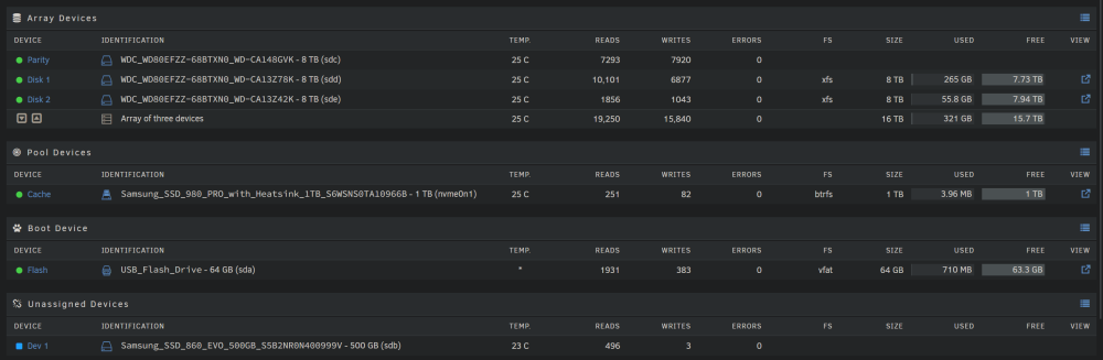

Can anyone confirm before I execute? I think at this point I just need to figure out the device IDs (edit: I'm blind). Will I need the UD plugin for that command to work properly?
Looking at my devices it looks like I should be running:
btrfs replace start -f /dev/sdb /dev/nvme0n1p1 /mnt/cache
Are there any other steps I'm missing, like disabling Docker and the VM manager? Should I leave the NVMe in the cache pool while running this command?

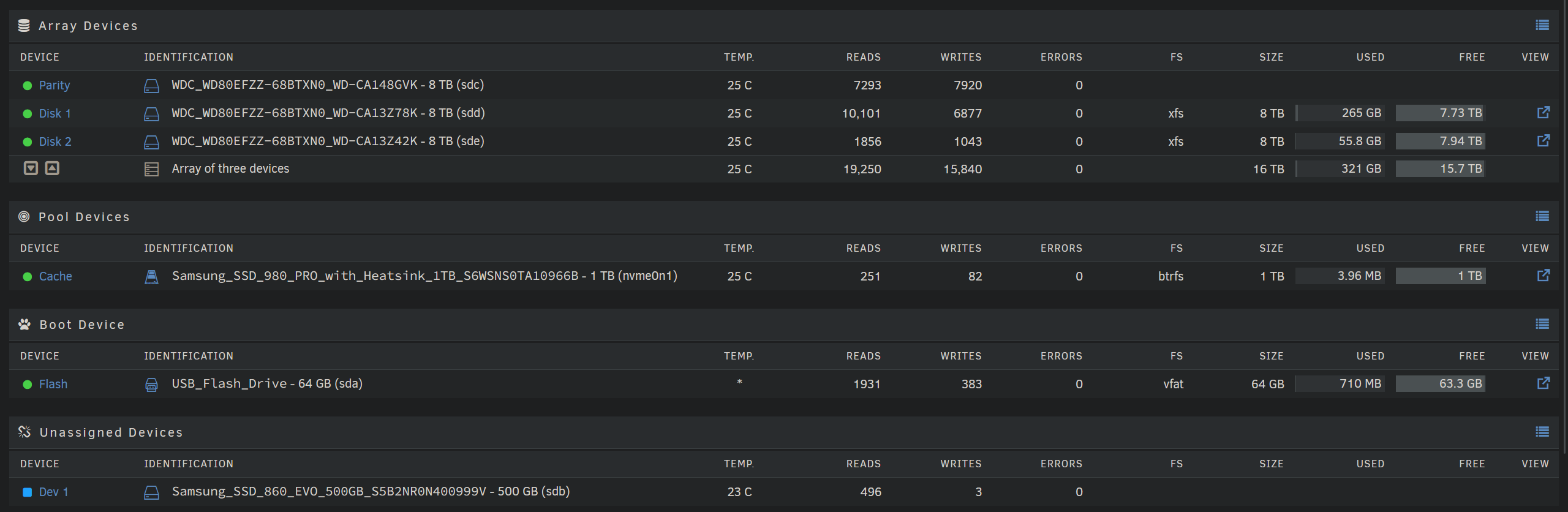

Alright, I'll play around with it some more and see if I can get things back to where they were. I downloaded Dynamix File Manager to make a backup of the old cache on my array and will copy it to the new cache from there as well.
Thanks for all of your help!
Edit: it worked! All Docker/VMs restored and working!
