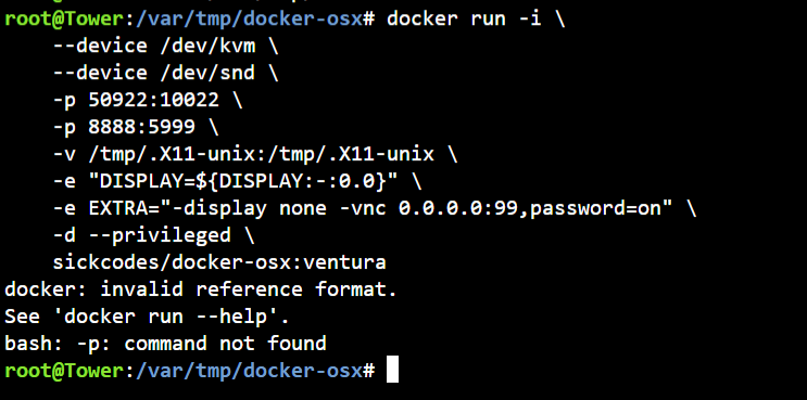

Can you expand on this command? When I run it in terminal I get this
Copy and paste it into notepad and remove the erroneous space after --device /dev/snd \
Then copy and paste it into your terminal.
That fixed it :) thank you!
