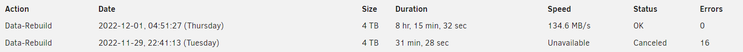

so i just woke up and have a very confusing messageimage.png.95607b54964b6d93480097f32310882c.png
i think the notification was just wrong because in the rebuild history it shows this
Post new diags please.
