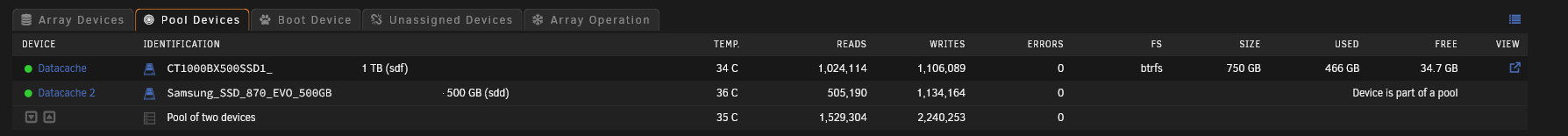

I had 2 cache drives and had a cache drive fail the other day. I took it out and added a new 500GB SATA 3 drive and now it's looking like this:

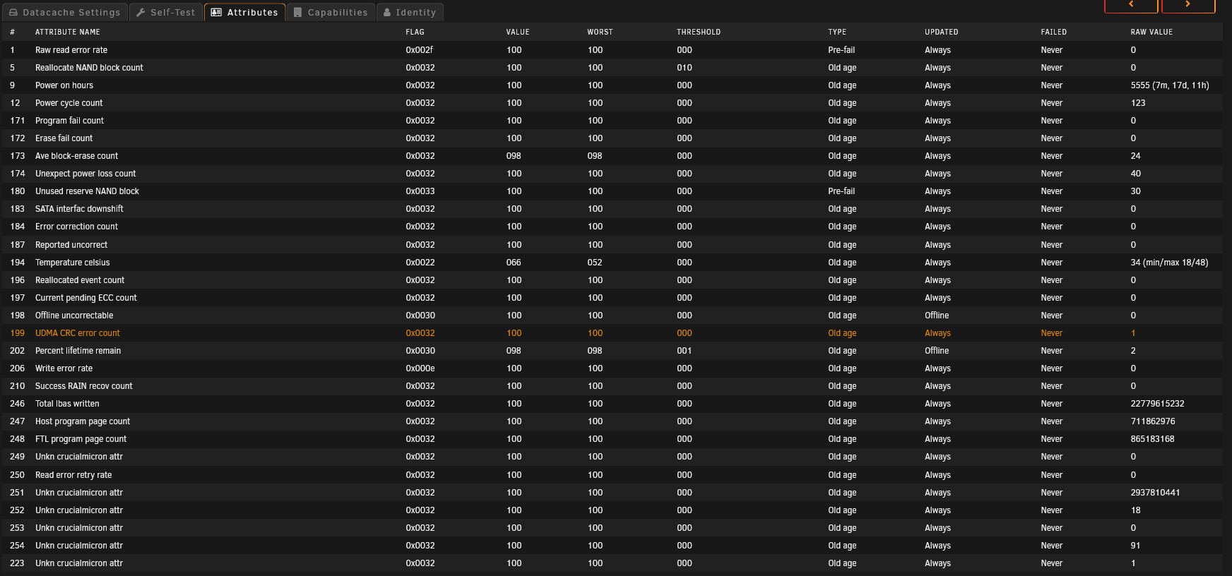

But now I'm seeing an error in my other previous SSD:
1980865416_Screenshot2022-12-03at12-06-25Dashboard.png.6992658e027445d0ecab0993b5198a12.png
I ran a Smart Extended Test and it said everything was OK (log attached) but looking at the Attributes section I think I saw something worrying:
The thing is, I have no idea what this means.
So I guess my questions are:
  1. What is this?
  2. How do I fix this/What should I do?
Could anybody help me, please? Thank you so much.

Solved by JorgeB
UDMA CRC errors are usually a bad SATA cable, just acknowledge the attribute and keep monitoring, as long as it don't increase it's fine, if it does replace the SATA cable.
Thank you so much, that's a relief.
Should I be at all worried with #1 Raw Read Error Rate which has a mention of pre-fail under type?
Also, shouldn't my Datacache pool have more space than just 750GB? My Datacache 2 drive which is the newly added Sata 3 SSD drive doesn't seem to be used. Is that normal?
Negative, that's just the attribute type.
It doesn't have 750GB, default is raid1 (mirror) so it can only mirror the smallest drive, look at the used and free space, if you want to use the full capacity you can convert the pool to single profile, but will lose the redundancy.
