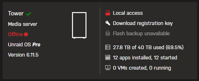

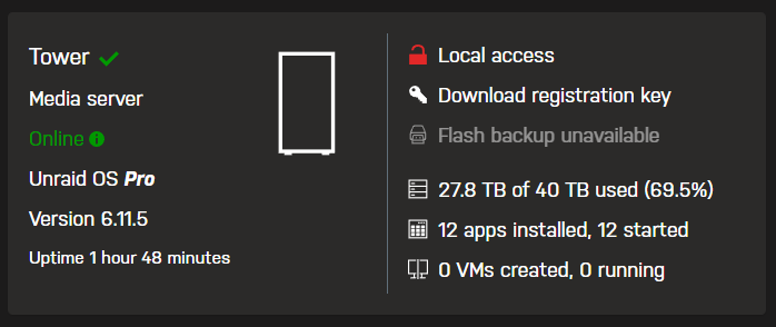

I recently upgraded all my hardware for my unraid server just a few days ago and merged all my data from my cache drive to a new one (I don't technically use it as a cache drive, I have appdata and other things stored here). Prior to the upgrade, everything was working as it should, however, the hardware was old and not great as I wanted to do more with my service. So I made sure dockers were turned off and disabled while I did the move. After the upgrade, everything was working fine. I was able to stream plex, was able to create VMs, etc. Then today, I noticed a few things:
1. My server name changed to "Tower" (used to be called "NAS")
2. "My Servers" keeps disconnecting and reconnecting every minute on its own throughout the day. Once it reconnects, it shows that it is remaining connected, but if I refresh the page, it shows that it is not.

The page I am refreshing is both "My Servers Dashboard" (https://forums.unraid.net/my-servers/) as it shows it connecting and disconnecting and also the Unraid WebUI as my server name disappears and reappears. I spent about 15 mins watching it and it seems to vary. a couple of times it will change after a minute, sometimes longer. If i refresh the page, it connects briefly and then goes offline.
In UnRaid itself, the name of the Server (Tower) up the top right will disappear/reappear. FYI, I have since changed the name manually back to NAS.

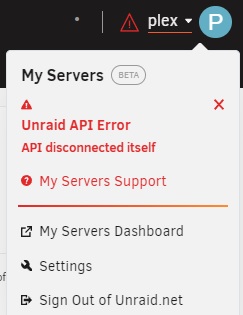

Initially there were no errors, however not long after posting ont his forum, I received a "UNEXPECTED TOKEN '<'" error under My Servers in unraid webui. Now just after recording with loom, I just refreshed the unraid server WebUI and now I am receiving an API Error (API disconnected itself). If i refresh the page it goes away, and comes back etc. I attached a screenshot of where I had received BOTH errors.

Edit: Ok, so I managed to get a snippet of the Unexpected token '<'," error occurring in the Unraid WebUI and have attached it below. Also managed to resolve the issues I was having with dockers. Turned out that NordVPN had changed my service credentials, just the password. I realised this when I noticed that the 3 dockers having issues had VPN enabled. Nothing else in my server uses vpn.
Still experiencing the API and Unexpected Token errors in both Unraid WebUI and in https://forums.unraid.net/my-servers/.
