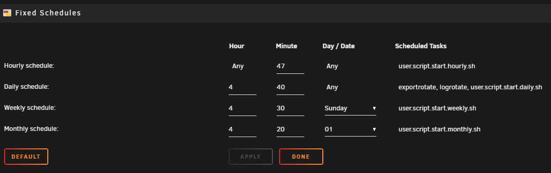

Out of chance I just noticed that this is the default time at which Unraid runs its daily tasks, as well as user scripts set to daily...
That is a great hint. I have two user scripts that run on the "daily" dropdown... Those scripts are backing up the USB drive like mentioned here:
I have those scripts active at least one year but I've deactivated them on the schedule to test if the scripts are responsible for the freezes.
I'm attaching the custom script, maybe someone has an idea what could cause the USB reset when running it? I'm confused about it because it ran all time without any issues, so maybe this is an issue that came up with the new unraid version?
