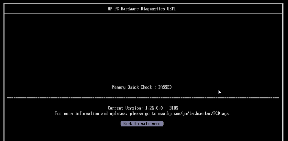

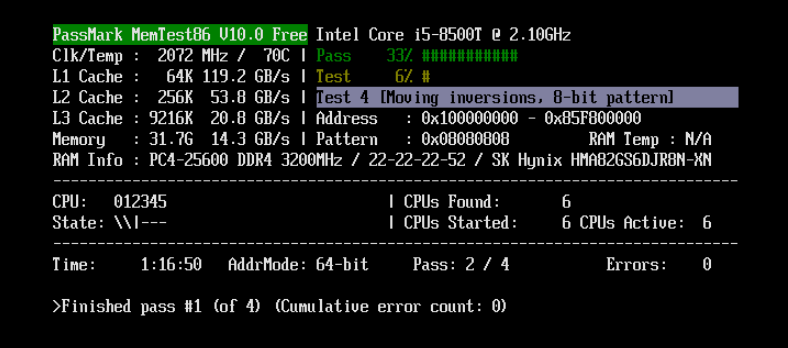

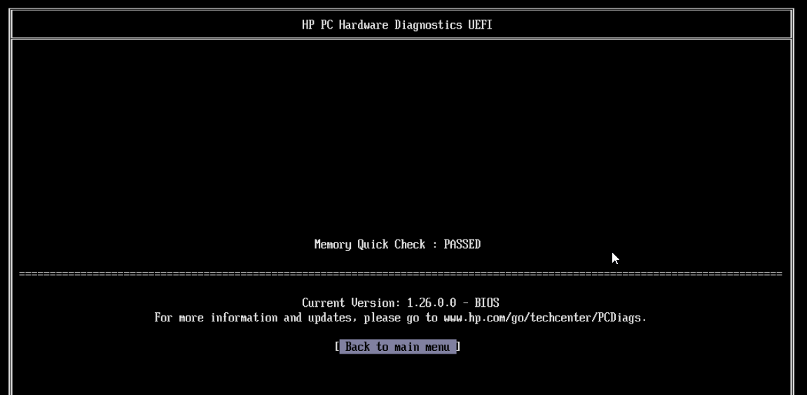

2 hours ago, ChatNoir said:
I think that JorgeB means to run a test from https://www.memtest86.com/
Will do, but I already replaced whole RAM with other one (was single 8GB, now I have two 16GB) still the same, so I think memory can be excluded ?
Edited by mucflyer
I think should be fine....
